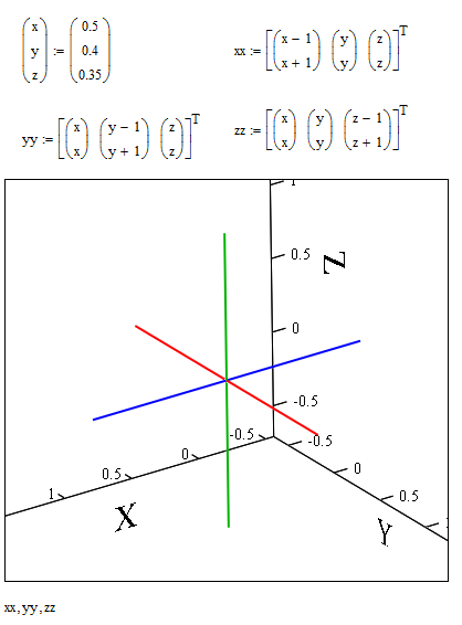

How to create 3-d line
How to create 3-d (vertical) line thru the center of gravity?
How can we more simple create the 1-st and 2-d (horisontal) lines?
See please the Mathcad 15 sheet in attach. Thanks!

Surely you didn't just want this:

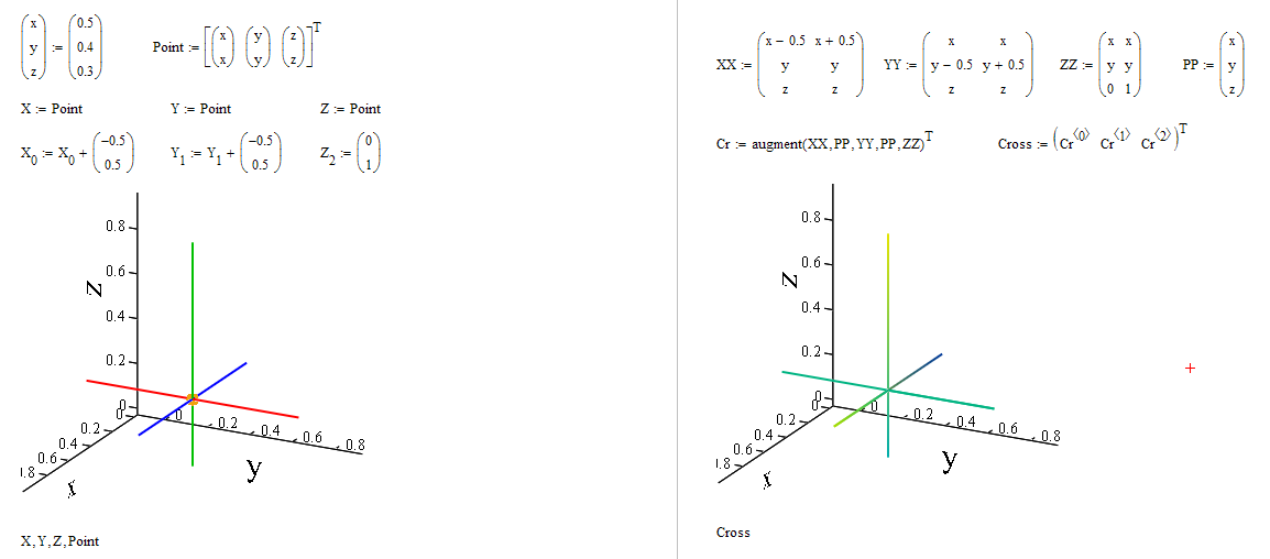

Here's another approach (again using scatter plot):
