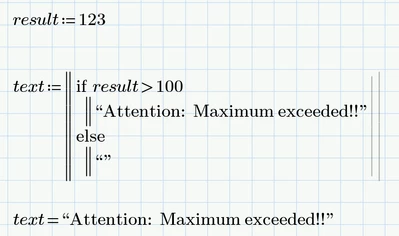

Of course you could use a small program sequence using the if-statement to return a text string. But the program would be visible in any case and the the string at best could be an empty string.
You could hide the creation of the text in collapsed region, but in case that no warning is to be issued, you would still see
or any text indicating that all is OK.
You can also use a scripted "Text Box" (-> Advanced Controls) and its not really clever that PTC had chosen the same name for them as for the text region.
Here you have more control concerning font, font size, font color or background color. Examples for this were posted here in the forum a couple of times. But it still applies that in case no warning is necessary, that Text Box won't vanish. It could display a different text or no text at all but it still would be here.
