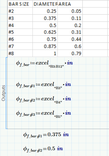

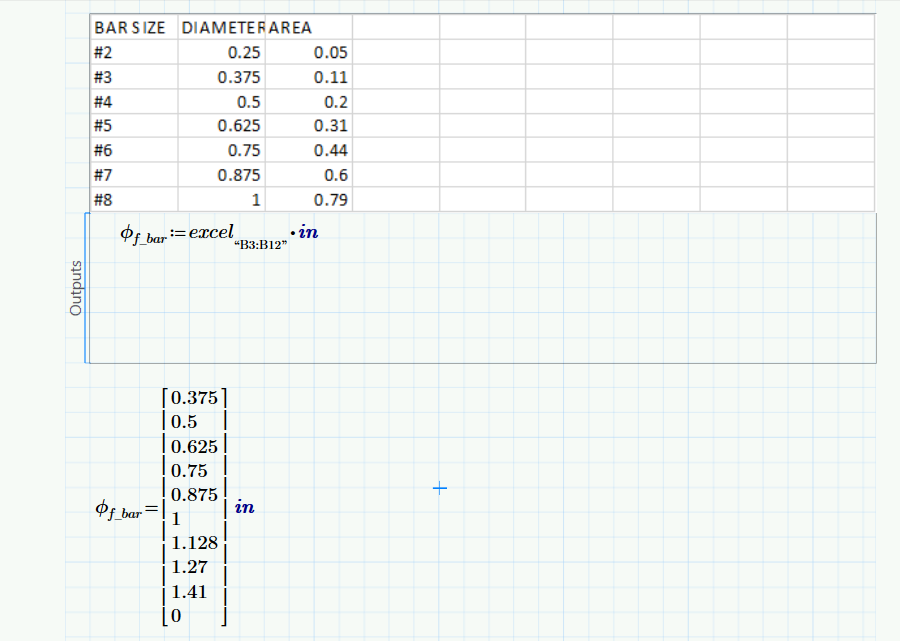

I am trying to do something like this but for every bar diameter, I just want to be able to type phi sub f and a #1 and just to get the properties of the #1 and corresponding. I do not want all the whole matrix to appear but just for the appropriate bar number I need. How do make this happen?

Do you need a look-up table that you can take data from?
f this is what you want to do then I would suggest using a table (example extract from a sheet I have been trying it out with).
The worksheet is in Prime 2, so it should work for prime 3  & 3.1.
The entry D_E returns a single row vector that could be adapted to give results based on different materials.
(Note that to use it as a 'real' vector you will need to transpose it to a single column vector)
Hope this gives you a few ideas to try

You can embed an EXCEL table in the spreadsheet, with a little creative addressing, have what you want.
July 18, 2016
In addition to what others have said, also take a look at the matrix lookup functions, such as "vlookup".

Hi Juan,
Try using the sample file that I have created & attached along with for your reference. Since Prime 3.1 does not have a drop down menu option & it does not appear that it is soon going to have this functionality what you can do is as follows:
1. Create a database in an excel file embedded in the worksheet.
2. Use an input variable to identify the bar number for which you want to call the diameter & area. This input variable will take the data from Mathcad worksheet & will use to extract the required data in the embedded excel file.
3. Use that input variable to extract the diameter & area in excel by using "vlookup" or "hlookup" depending upon your dataset & your preference. (I have used "vlookup" to extract the values).
4. Use output variable to get the extracted value from excel into the Mathcad worksheet.
I have used just the numerical values for the sample file. You can also use this method with units attached to the values so that you can get the real benefit of using Mathcad. Otherwise the same thing can be done in MS excel also.
