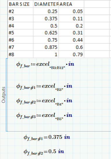

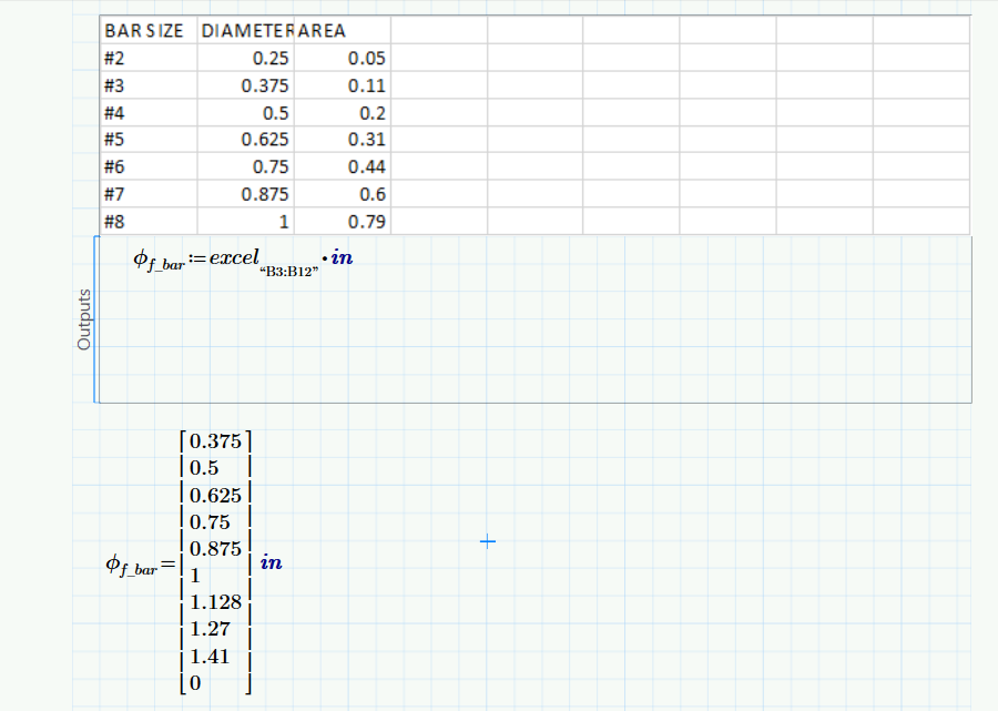

Q4.pngI am trying to do something like this but for every bar diameter, I just want to be able to type phi sub f and a #1 and just to get the properties of the #1 and corresponding. I do not want all the whole matrix to appear but just for the appropriate bar number I need. How do make this happen?

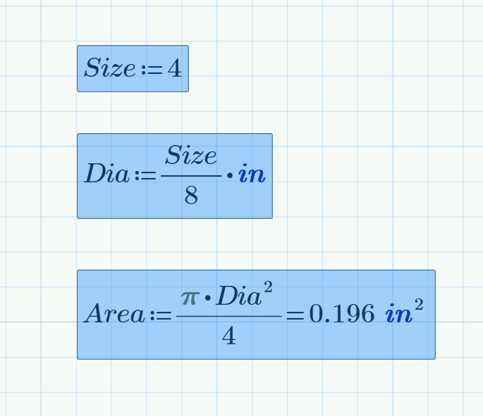

This is a very simple problem as you have defined the bar number as the number of eighths of an inch hence the diameter is simply the bar number divided by eight.  As the bars are round the area is also very simple, the formula for the area of a circle.
My suggestion is that you not bother with the creation of the values in Mathcad but simply create the spread sheet with values and then import it into your work sheets.  Mind you as the data is so simple it will be simpler to calculate each time in the work sheet.

October 28, 2016
If you are asking about how to import an excell spread sheet then you use the following
There are parameters that need to be filled in but you can get that from the help file.
There are other functions that can be used READPRN, READTEXT, that you may also use.

October 28, 2016
I suggest you simply do the calculations in the wok sheet
Simple.

But he's talking about different materials as well as different sizes, and a wide range of choices; so entire calculation in the application is not practical.  Burying all of the non-computable information in an EXCEL component, and creating a template with that component would be an attractive alternative.

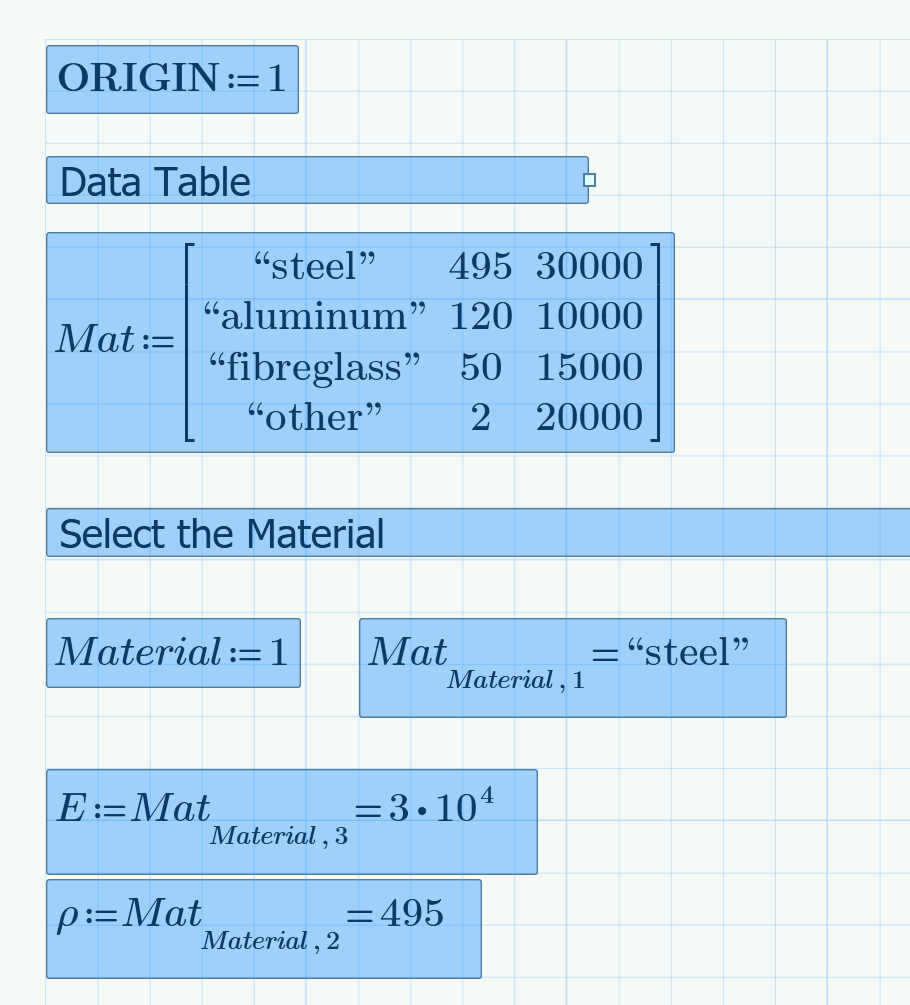

November 1, 2016
I would have suggested that the material type could also be a variable, I would use a radio button in Mathcad, as the rest of the calculation is the same.  Mind you it is possible to force a selection of material as well which could then define the mechanical properties.  For instance:
A simple solution.
