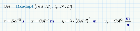

I have solved a DGL with Rkadapt-Routine (Runge-Kutta-Verfahren, adaptiv) , whitch generated following arrays:
Now i want to build the acceleration-Matrix by dividing vx over t.
So i have to divide each Element and write them into a new Matrix for the acceleration.
I think we have to write a little program for it and that's my problem.

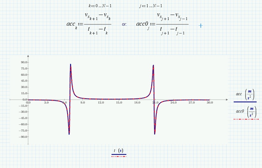

Hi Volker,
I have adapted the worksheet to PRIME 4 (with carriage return for the sum and subtraction, and constant font size) as well as having traced the graphic of the acceleration calculated in two different approximations.

Actually, you want to take the difference in the velocities and the times, and divide those:  acceleration is the slope of velocity
first element Acc[0 will be null

Thank you all for your efforts.
That works perfectly!
