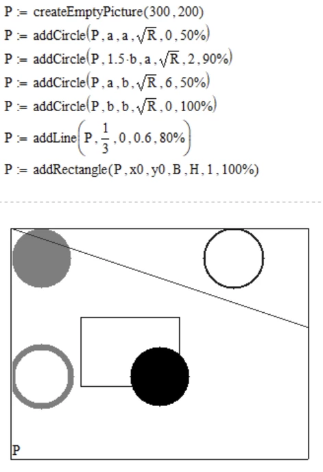

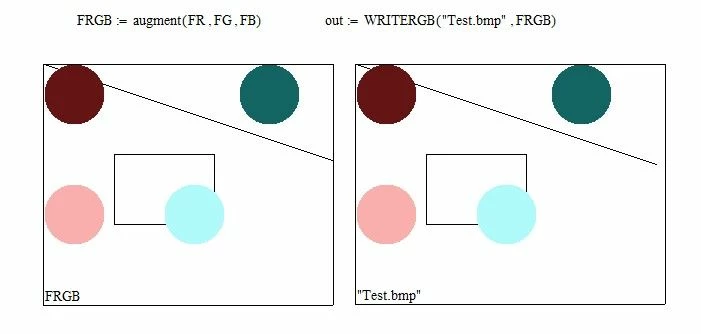

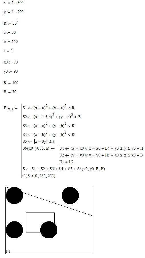

I could not be bother to create functions for adding letters and numbers in pixel graphics, but here are some functions which may make it easier to add lines, circles and rectangles (either outlines or filled) in a pixel matrix. The functions were written for grayscale imaged as the one used by you, but could easily be adopted for color images as well. Actually a color image is just a vector consisting of three grayscale images, one for each primary color.
Other geometric primitives could be added and adding texts may use a similar approach.
MC15 sheet attached

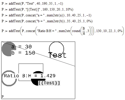

I could not resist 😉
Here is a basic function to add text to a bitmap graphic.
Feel free to add bold, italic or rotation.
Because of the 'reversed' x-axis, xpos/ypos denote the position of upper left corner of the text bitmap.
The characters were created by using the screenshot of a text page written in a monospace font.
Word file and screenshot image are attached but not needed for the Mathcad sheet to run. The data is already embedded in the Mathcad sheet.
Initially I used the higher resolution file characters.bmp but autosave (which I have set to activate every few minutes) took quite long and this was annoying. So I used the scaled down characters3.bmp.
