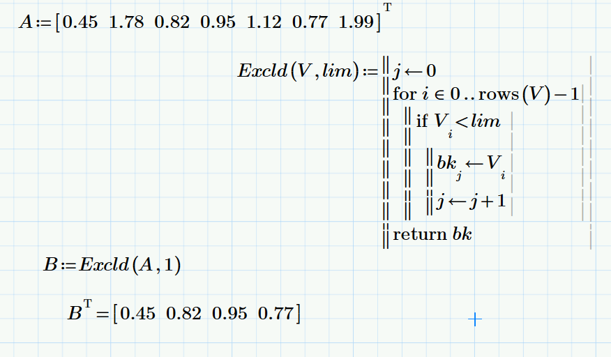

If i have a vector A=(0.45, 1.78, 0.82, 0.95, 1.99,  1.12, 0.77), how to create a vector B that contains only B=(0.45, 0.82,  0.95, 0.77); only values that are lower than 1. The other values may be 0 for example.

But is number 3 in this case considered as the second number or third number of the matrix? Because the output of the matrix must be with the same number of elements. I need them to be connected with some other vectors.
23-Emerald V
October 18, 2016
"3" is the second number in the vector.
Your example shows a vector B that is shorter than A. That's what my  (and Fred's) function provides.
Please specify more carefully and exactly what you want.

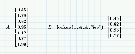

In Prime . . . You could just use the lookup function...... like this . . . much simpler
