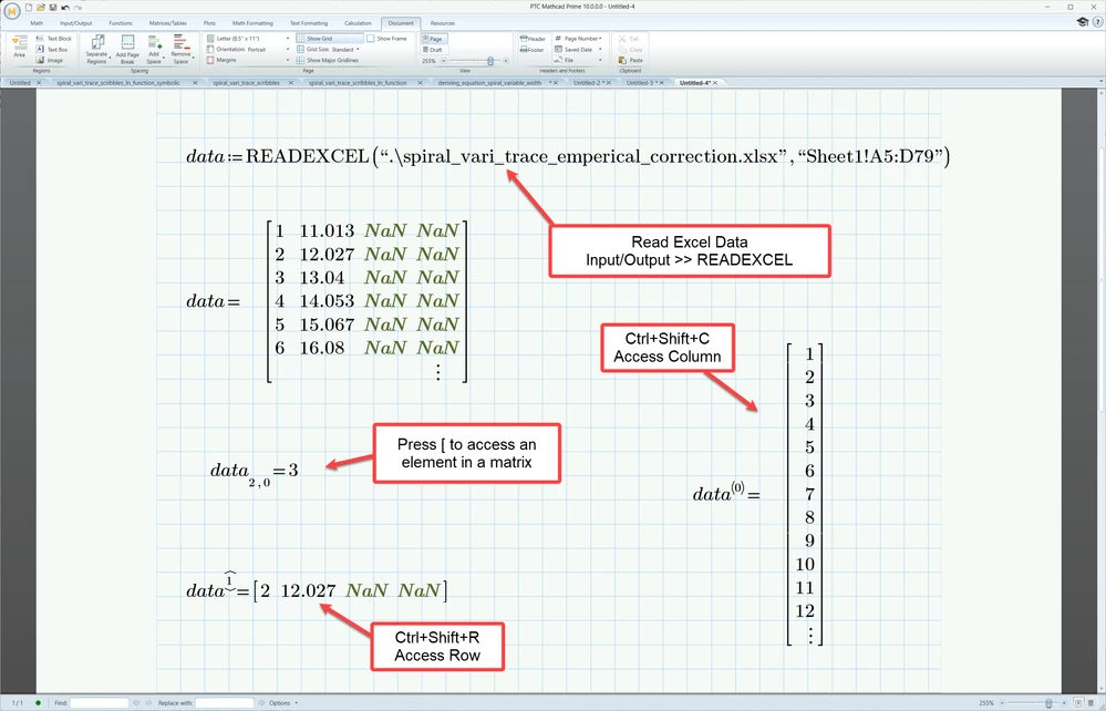

Using the column operator.
type: data {ctrl-shift-C} n
Where n is the column number you want to select.
{ctrl-shift-R} n will extract row n.
Stuart
https://support.ptc.com/help/mathcad/r10.0/en/?utm_source=mathcad/index.html#page/PTC_Mathcad_Help/row_and_column_operators.html
Nov 10, 2025 12:53 AM UTC
Ctrl+Shift+C  --  Access Column
Ctrl+Shift+R --  Access Row
Press   [  (left square bracket)  to access an element in a matrix
