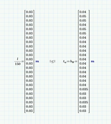

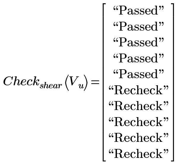

Hi all, I've created a vector values as shown below and I want to check the design for each of the value is pass or not.
does anyone know how to create an 'if statement' to get the results as shown below?
Thank you for your kind help.

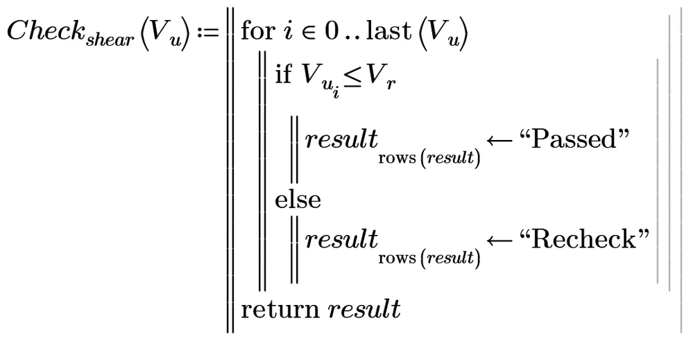

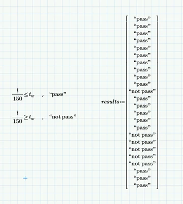

Sep 13, 2024 8:24 AM UTC
Here's one possibility:
ttokoro

My Vr is in vector value and not in a single value? can you make it works?
