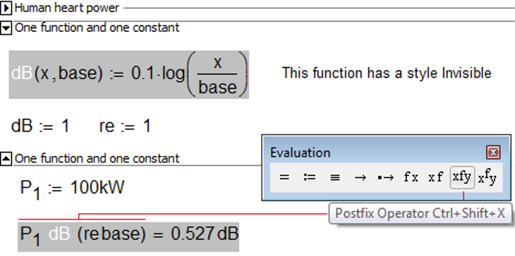

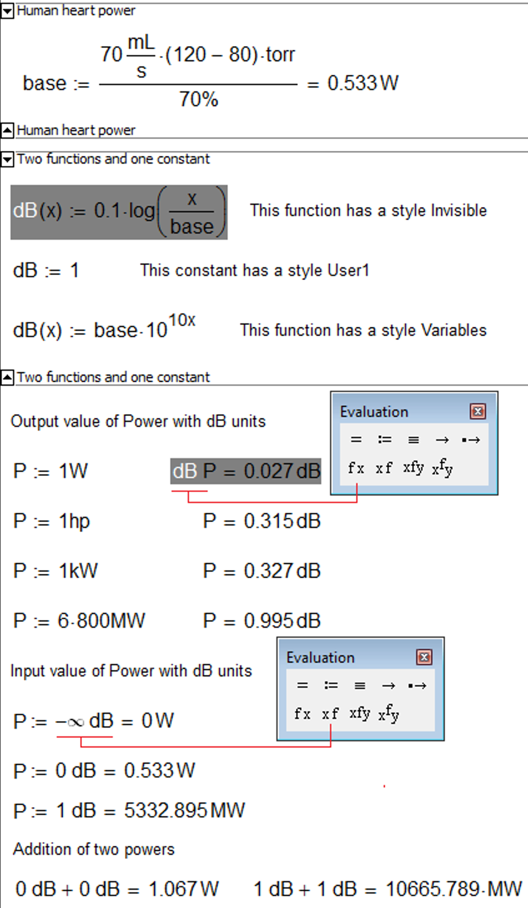

Here's a Mathcad 15 worksheet that shows how to use dB. I've posted this before (more than once, I think; see here for the original post in a discussion, or argument, about dB: Solved: Re: Working with dB (decibels) - PTC Community). I converted it to Prime, and it doesn't work; it just throws the error you have already seen. So I think you are out of luck. Yet another deficiency in Prime.

One general remark.
We have use dB, pH etc. only in manual calculation. We does not need dB, pH etc. in computer calculation.
And partially 2 pictures from the book Thermal Engineering studies with Excel, Mathcad and Internet

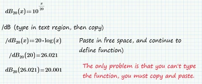

The Prime shortcut for special characters is different than Mathcad 15.0 (Ctrl-Shift-K).  First, type a double quote (which in 15 gave you text, but not in prime).
In between the double quotes, type /dB
     "/dB"
Now delete either of the quote marks and follow this variable with a parenthesis to make it a function
     /dB( x )
Press : and define the function.
In Mathcad 15, you could make this a postfix operator, but these aren't implemented in Prime yet.
pwanis1-VisitorAuthor
February 8, 2016
The good news: this trick (using quotes) worked, and I could enter the formula exactly as you said.
The bad news: mathcad still doesn't appear to be treating this as an inverse function; even when I do declare /dB(x) I still get the error no_inverse_declared. Unfortunately I think Richard Jackson hit the nail on the head.

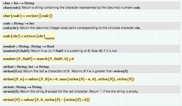

Some general-purpose string functions:

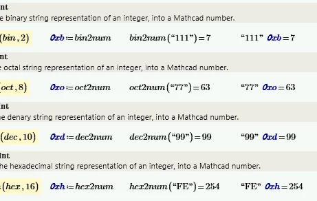

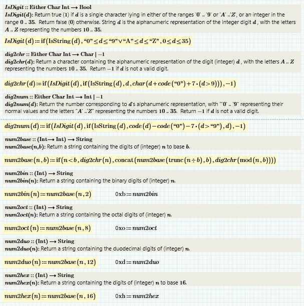

Integer to Base conversion functions (number to string😞

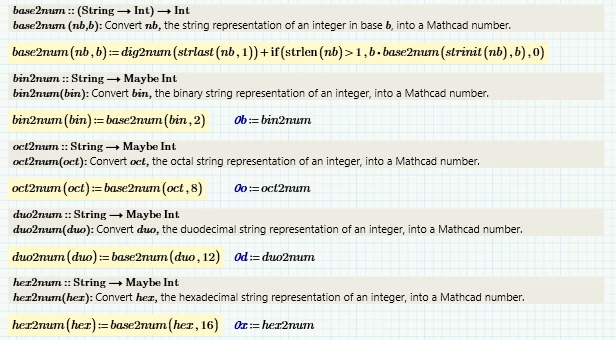

Base to Integer conversion functions (string to number😞
I've got another version that works better with str2num ... I'll throw some documentation around it and, hopefully, post it later on today.   It's a bit "ragged" though, as it's in development, and uses some vector and string functions that are stepping stones to a more general, Mathcad-oriented, array handling capability.
