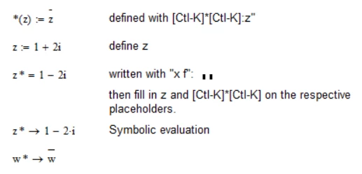

Both in maths and in engineering texts, the  complex conjugated of a number or a variable or a function, is indicated with an asterisk. My attempt to create the new operator c.c. Is not satisfactory, as can be seen from the following picture:
Can you do something better?

Like this?
LucMeekes23-Emerald IVAnswer
July 24, 2017
Like this?
