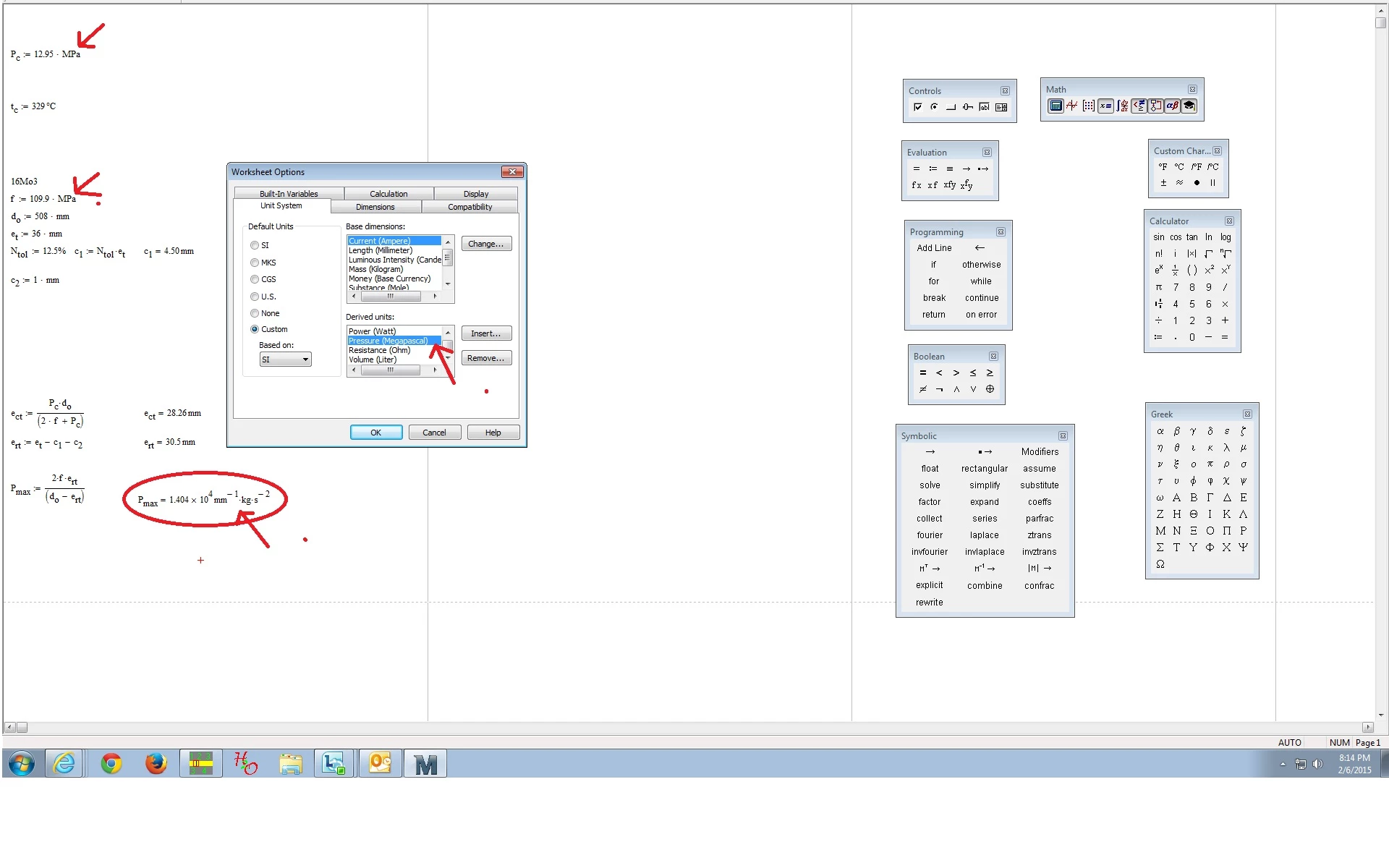

Hello all,
i try to customise the worksheet unit , to get the final result unit in Mpa(megapascal)
i tried it by
menu- Tools / worksheet options / unit sytem / default unit-cutom unit / pressure megapascal
even though i have customised the worksheet unit system . i am not able to get the final result in Mpa
please see the attached mathcad file and pic
Werner_EAnswer
Do you know that you can show your result in any unit if you type that unit in the black placeholder after the displayed unit? Click on the result you want to see in Megapascal and type MPa in the placeholder - Mathcad converts the result accordingly.

bk_011-VisitorAuthor
thanks for your reply,
now i can able to convert my result to Megapascal ....thanks for your support
I encounter a strange effect when I open your sheet.
At first I see the same as your screenshot is showing, but when I type P.max= I get the result with unit MPa immedeatly as you had set it up as default.
When I copy the region you typed and edit it (I deleted the = and all but the P and retyped it) I again get the result in kg/(mm*s^2).
Looks like a bug to me.
