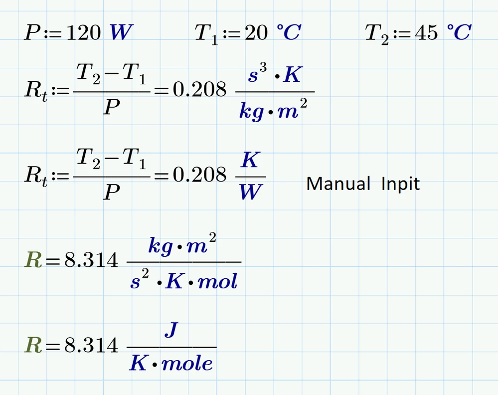

I use Mathcad 2015 and when I calculate thermal resistance in K/W I get output in completely different complicated units using meters and seconds. How to force Mathcad to give me result with desired units?

When you evaluate an expression, there's a placeholder for units behind the result value. You can fill in the K/W and the other stuff will disappear if unit of the result actually is K/W.
You may want to check what the setting for units is that you use with your worksheet (Tools->Worksheet Options -> Unit system). It can be set to SI, MKS, US, CGS or none if I'm not mistaken.

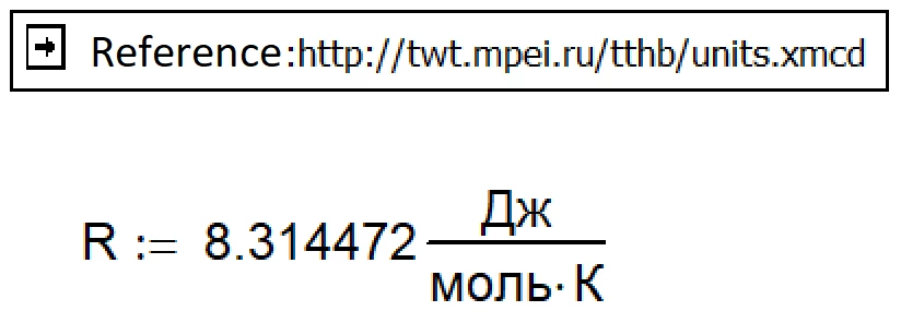

I do a reference on one Cloud Mathcad sheet and have for example Russian units
I can add in this file your custom units!

I think we must do it manual each time
