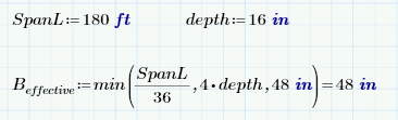

Lets say I have such example:
B effective should be the smaller of:   Span L/36     4*depth h   48 in
How can I create such algorithm in Mathcad Prime so it returns a minimum value so it controls (or governs0. In some cases it could be a Maximum value.

Similarly, use "max" to find a maximum.
MJG1-VisitorAnswer
September 8, 2016
