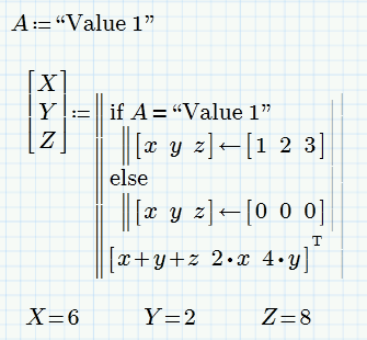

A simplified example probably illustrates my question best:
I would like to set multiple variables based on the value of A in my example above.

You're using the 'equals' operator "=" where you should use the assignment operator for programs "<-".
So do like this:
You use:
to test if A equals the string "Value1". The result is either True (nonzero) or false (zero).
You use:
to assign a value of 3 to the variable x, outside of programming.
Inside of a program, the assignment should look like:

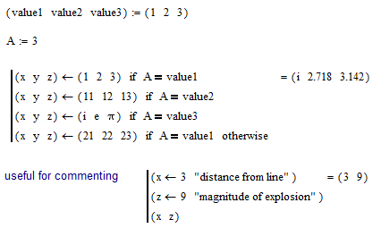

Luc's answer is the correct one.  Here's another way of assigning values en masse that I sometimes use to make a program more visually compact.  Given that Mathcad can do calculations inside an array, you can also use a variant of this method to attach comments to an expression (to ensure they remain aligned).

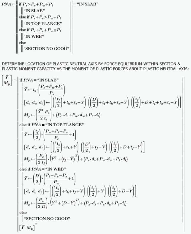

I thought you might like to see my final program:
Comments are appreciated if you see something I could do better.
