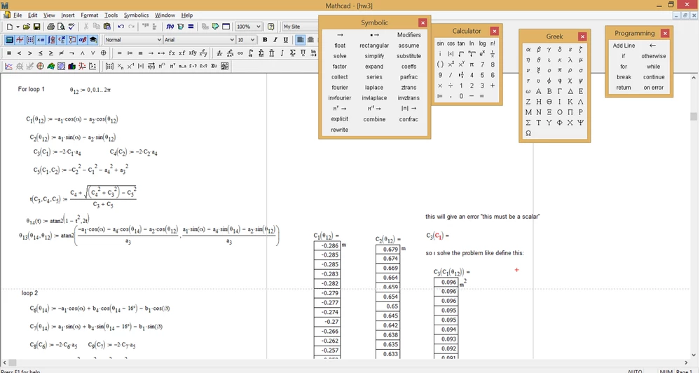

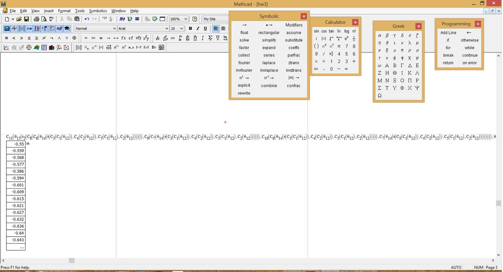

ı need to take some plot and ı start to define eqn,
first eqn dependent one variable
second eqn dependent 2 variable
third eqn dependent 3 variable
and it is going increase thus the equation will be very long
is there any thing to shortly define this kind of eqn?

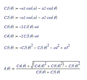

I get this funny feeling that the C1 you are using the definition of the function C3(C1)  is the C1 function that is defined on the first row, etc.
So actually what you want to accomplish is this:
That is you may have a complicated function, but it is of a single variable....

Its unclear what you are trying to ask and your screenshot does not show a single equation and no function definition either (which seems to be what you mean by "equation").
Maybe its best if you try to show what you are asking for with a simplified example.
citkit1-VisitorAuthor
December 10, 2017
in the picture i take screen shoot of first equaiton set. in the stage is not proble define like C3(C1(theta12)) but after same stage ı get 5 dependet variable equation, and ı need to define shortly this equaiton.

All your many variables, could be just two or three vectors.
