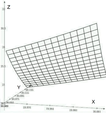

How to define xy axis in 3D plot drawing by matrix
Hi all
Please, see the attchd.file.
There is a graph where I would like to represent parameters x and y related to z.
I have no idea how to define the x and y axis.
Does anybody have an idea how to do that? Thx

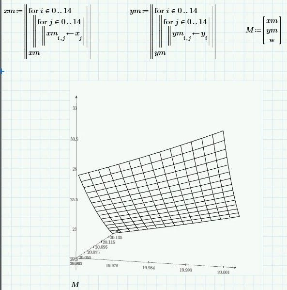

Yes it is necessary to establish a nested vector of the x, y, and z coordinates like this

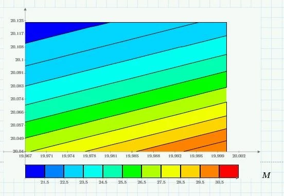

A contour plot is the best way to visualize the resulting nested M matrix

How about creating an interpolation function? See attached sheet.
As your data matrix is square its not clear if x would relate to the columns or to the rows.
In the attached sheet I assume that x would relate to the rows, and y to the columns.
If it should be the other way round (as Terry assumed), you simply have to exchange X and Y when calling linterp_2D().
