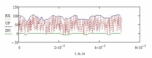

May 26, 2018
If the given signal is sampled, a digital notch filter tuned to the frequency of the signal should be used in such a way as to attenuate only the carrier while the noise is emitted at the output. To have the envelope a peak detector is added with a capacity ...........

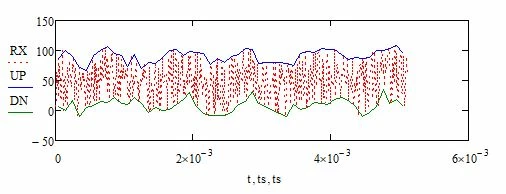

May 26, 2018
You must break the signal into segments and find minimum and maximum of each segment.
May 26, 2018
Sorry a mistake in the lower envelope is corrected here.
23-Emerald V
May 26, 2018
That's extremely simple. For the problem as posed the lower enevlope is XT, the upper is XT+1.
But I guess that's not what you're after. What do you know about your signal, and what exactly are you after?

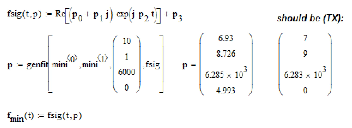

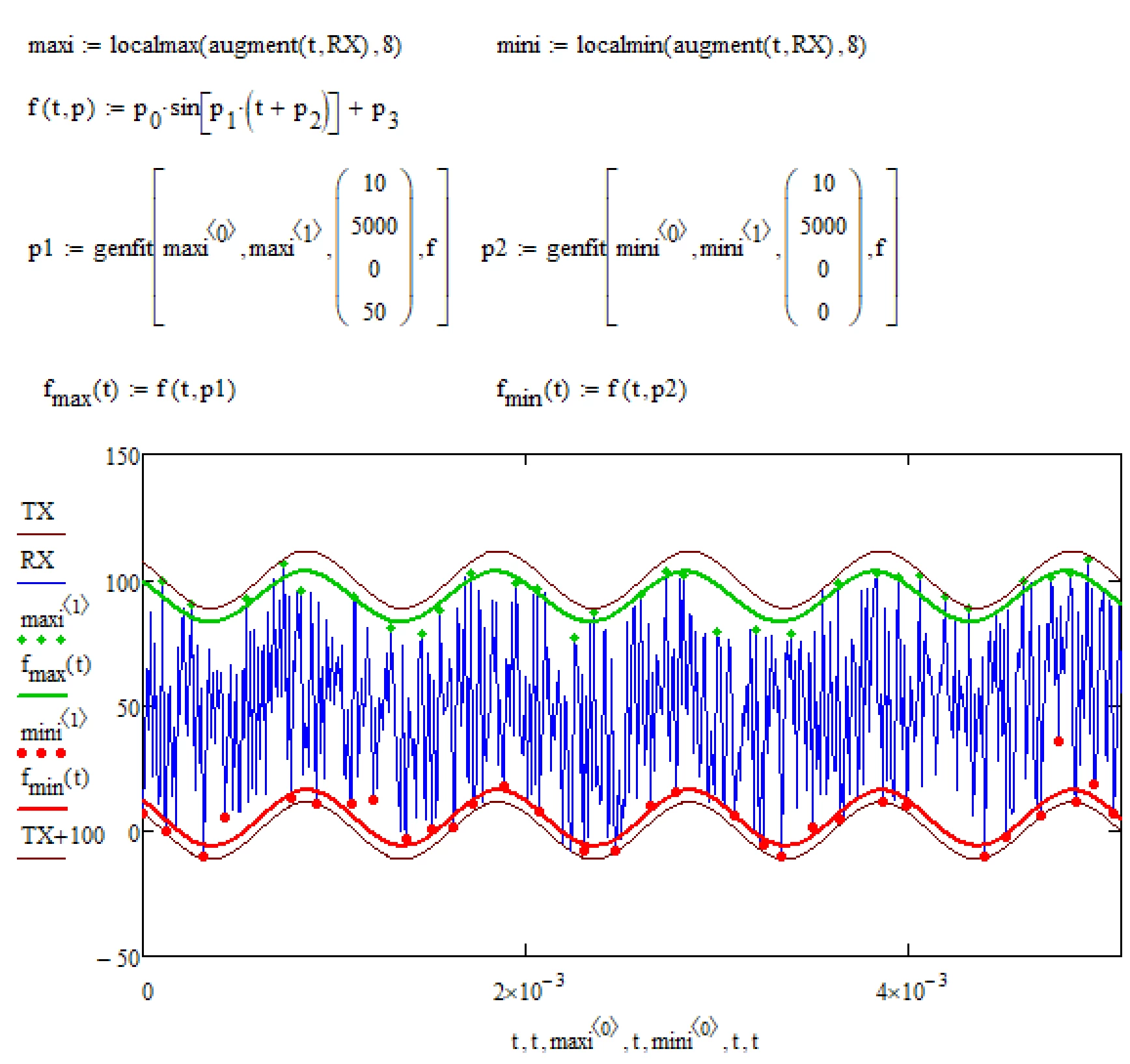

Would this help?
You may play with the windows size (I have chosen 😎 and may notice some sensibility wrt the guess values of genfit.
May 26, 2018
You may also use your way of defining the signal for genfit.
The sensibility wrt the guesses and the window size remains though.

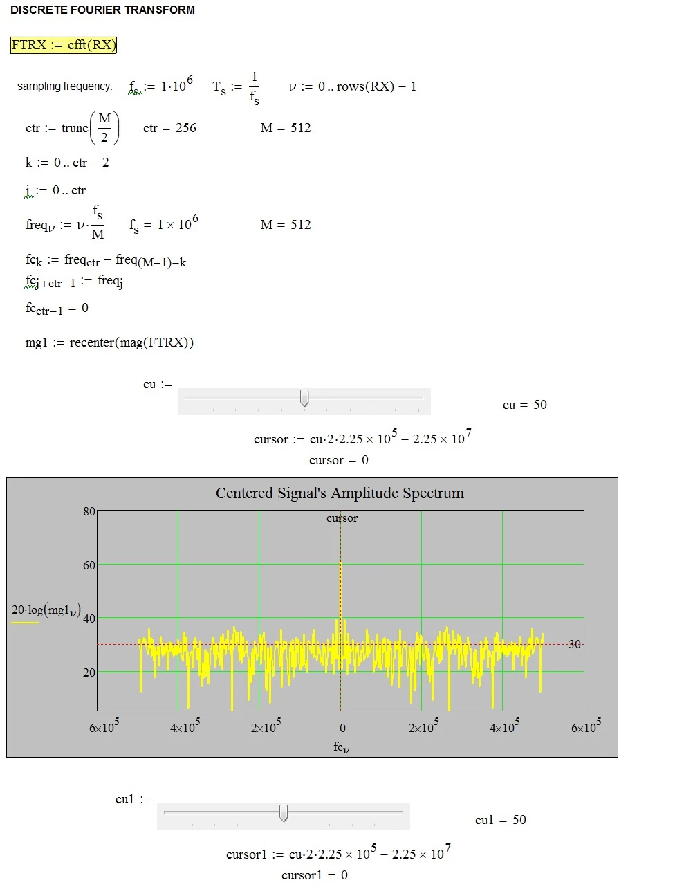

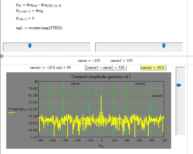

May 26, 2018
This is not an answer to your problem. However, can the following analysis help you?
May 28, 2018
Thank you for the effort could you please upload this mathcad file (of this program) ?
May 28, 2018
Attached is the file with the graph with three cursors to read the values of the frequencies and the amplitude in dB
May 28, 2018
Invalid solution. Wrong solution.
May 28, 2018
can you upload the mathcad file ?
