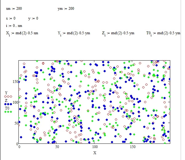

How to do clustering in mathcad ?
 For example i have deployed some random nodes in (200x200), but the problem is i want to form some random cluster's, like the given graph, please look my mathcad file !

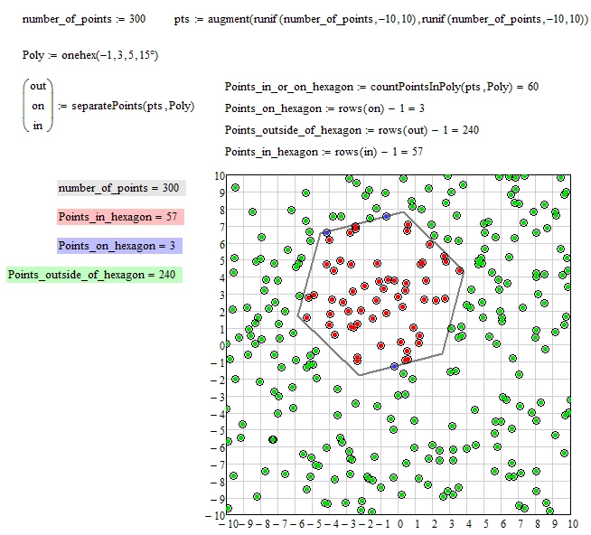

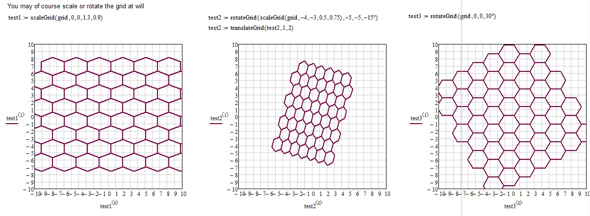

OK, now I found the Jordan routine I was talking about.
I added it in the attached worksheet along with some routines to scale, rotate and translate the grid
and also included an example how you may use the program to count the number of points in one hexagon:

Jun 7, 2018 7:46 AM UTC
no i not looking for this solution i have attached modified mathcad file please go through it (inform me if have some question regarding it) !
Jun 7, 2018 9:33 AM UTC
I have modified my mathcad but i don't know how to expand for full block !! please check mathcad file !
