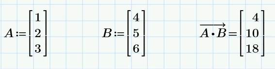

For example,
A := [1 2 3]
B :=[4 5 6]
I want to have C=[4 10 18]. In this case, how can I express it in mathCAD?
Please help me!
Werner_EAnswer
Jun 14, 2024 5:39 AM UTC

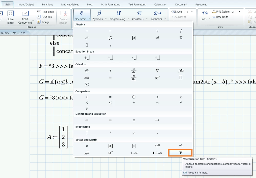

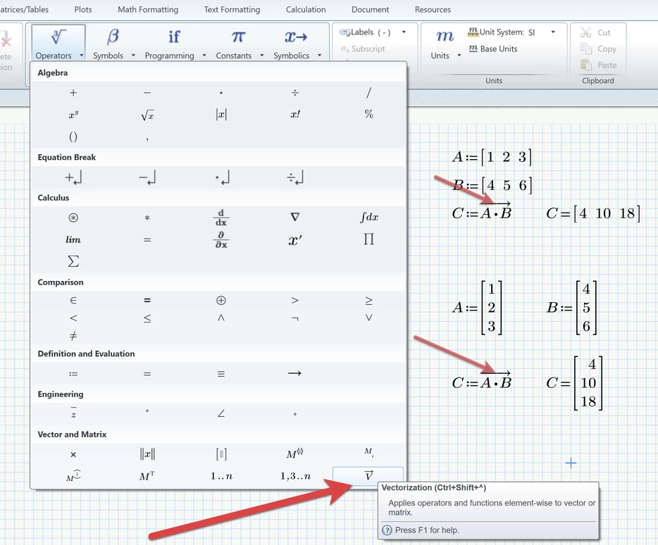

You have to use "vectorization"!
Prime 10 file attached
