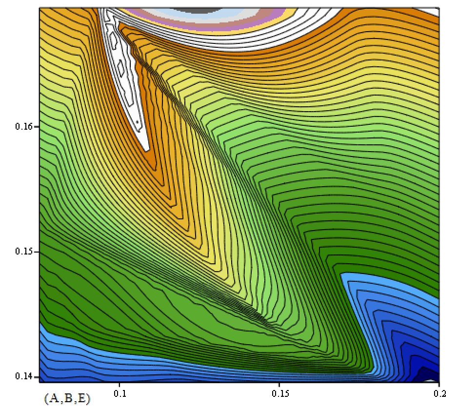

See please the Fig. 18.6. Solution of Differential Equations with Additional Parameter
here Study 18. Differential Equations in Thermal Engineering
December 1, 2016
Counter plot: blue sea, green forest, snow mountain, volcanic crater etc. Fine picture!

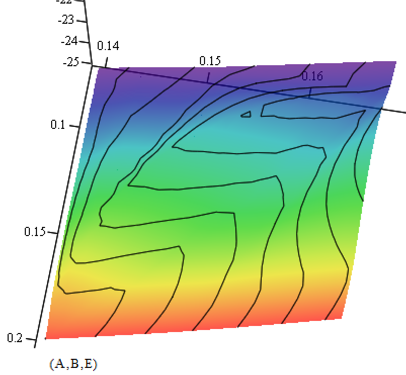

Dear Valery Ochkov,
Thank you very much for your answer.
But, I cannot able to see the 3-D plot in the code you attached.
I can just the box containing values (A,B,E).
Could you tell please what will be the problem ?
December 1, 2016
Do you see the counter plot in this attach?

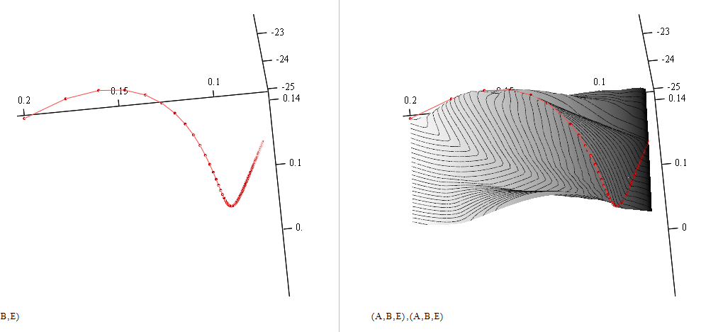

Dear Valery and Exinger,
1. I can see the counter plot of Valery's attached file in test_3D_plot-2.
2. I followed the Werner's instructions, now I can see the 3D plot.

But the counter plot is more fine. Not true?
Point me please one physical meaning of the plot!
December 1, 2016
Are you sure that you are looking for a surface plot and not a simple curve in 3D-space?
After all thats all the information you have. Look a the pic below. You simply have to change the plot type from "surface plot" to "scatter plot" (or "Data points").
BTW, does anybody knows what kind of surface Mathcad's 3Dplot component does create in a case like this?
