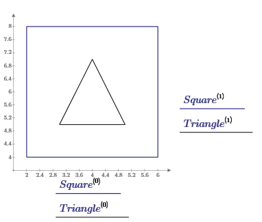

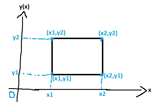

1. Given the below points: (x1,y1), (x1,y2), (x2,y1), (x2,y2), how to make a rectangle in Mathcad Prime based on this points?

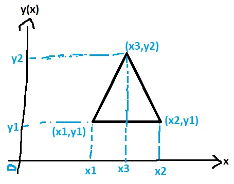

2. Given the below points: (x1,y1), (x2,y1), (x3,y2), how to make a triangle in Mathcad Prime based on this points?

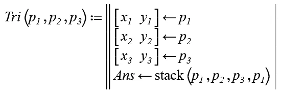

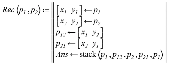

You can do both with this simple function:
where pl is a nx2 matrix of (x,y) points. Examples:

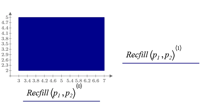

Cornel19-TanzaniteAuthor

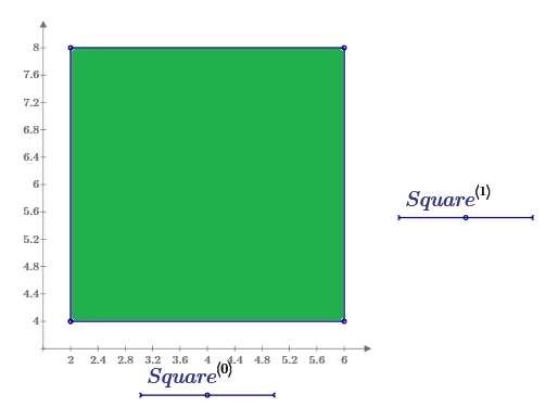

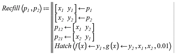

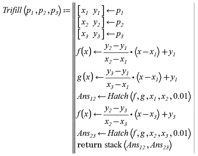

Aug 1, 2023 1:06 PM UTC
Is it possible also to put some colour inside the square/rectangle?
23-Emerald V
Aug 1, 2023 1:07 PM UTC
Sure, refer to the other thread on colour filling.

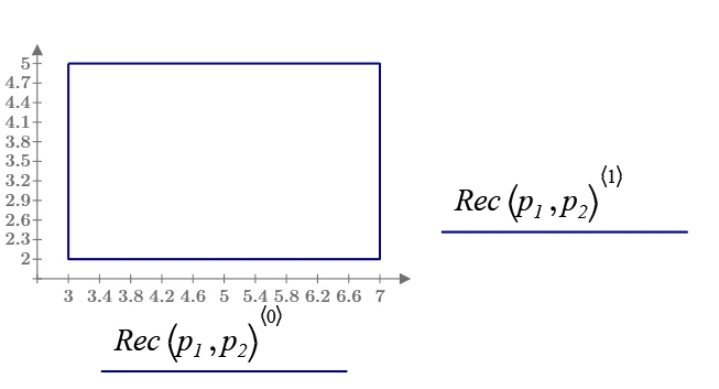

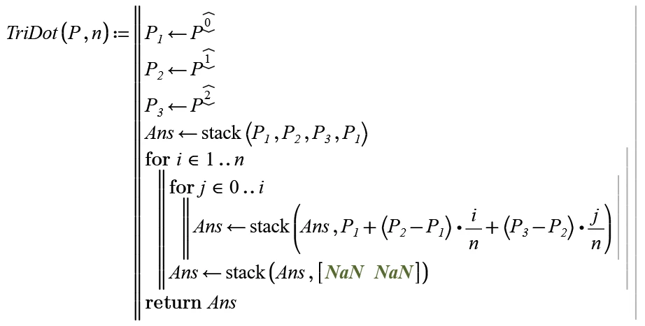

ttokoro
Aug 1, 2023 1:24 PM UTC
t.t.

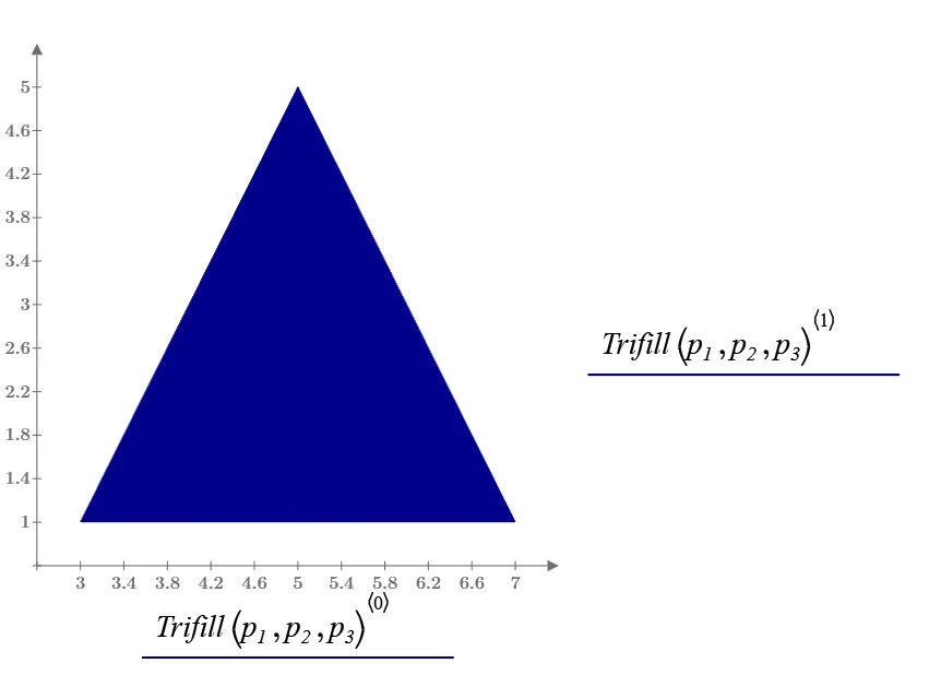

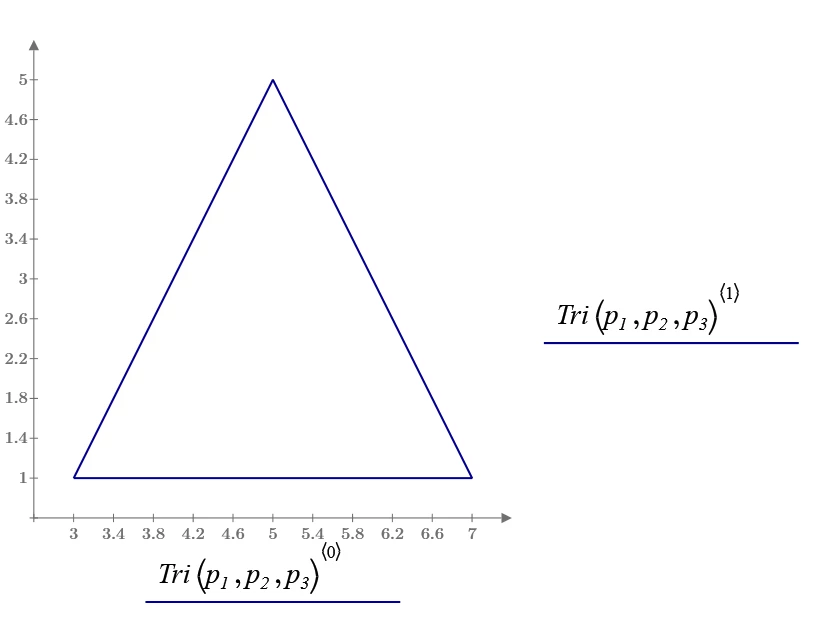

ttokoro
Aug 1, 2023 1:27 PM UTC
This is only p1=[3,1],p2=[5,7],p3=[7,1] type.
t.t.

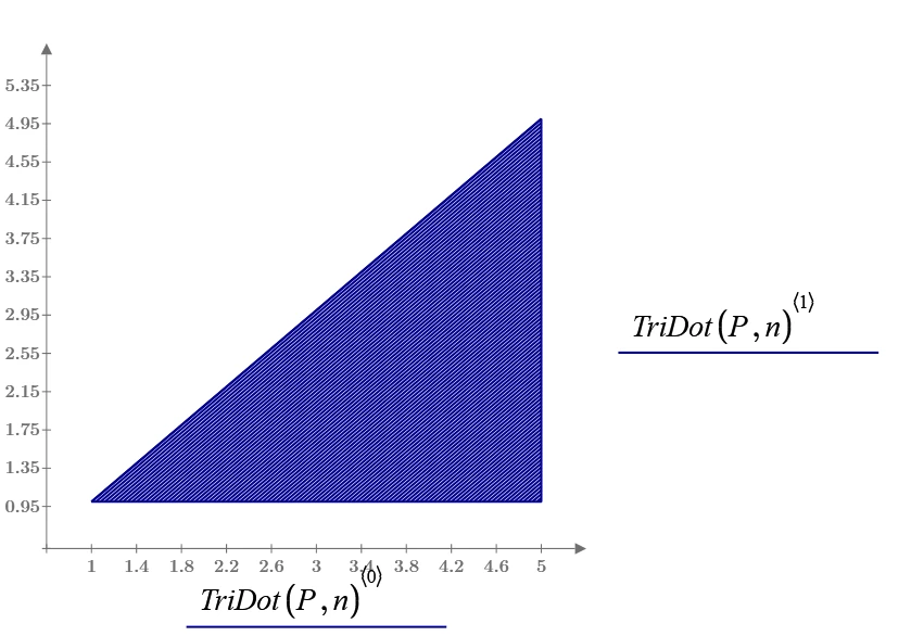

ttokoro
Aug 2, 2023 5:46 AM UTC
t.t.
