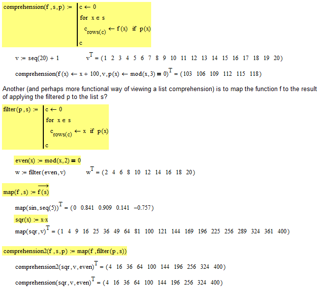

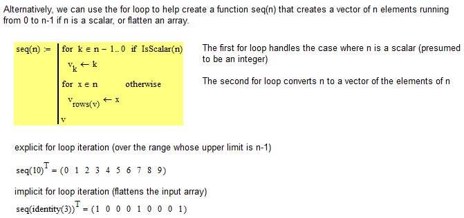

If it's of any help, I've written a simple list comprehension function in Mathcad 15, which should work in Prime (I'm not at my Prime PC at the moment, so can't check, but I'm reasonably confident that they do work in Prime).  There ought to be a similar feature built in to Prime but I can't see that happening any time soon.
The function seq is just a simple integer sequence generator function.  Here's one of the several variants I play around with.
Stuart
