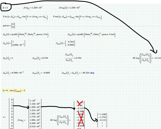

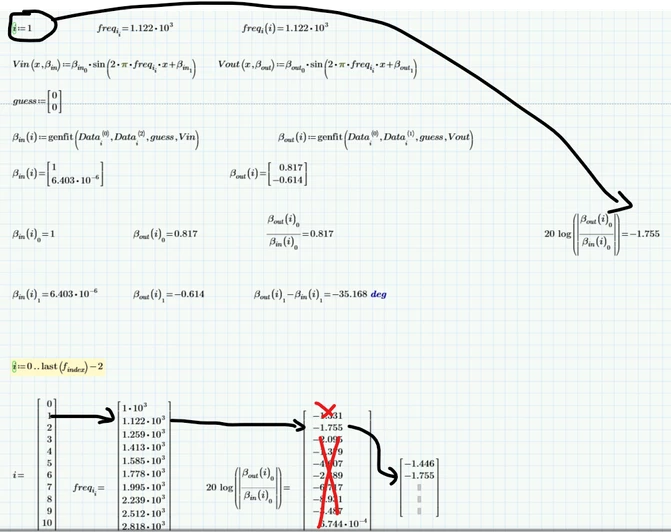

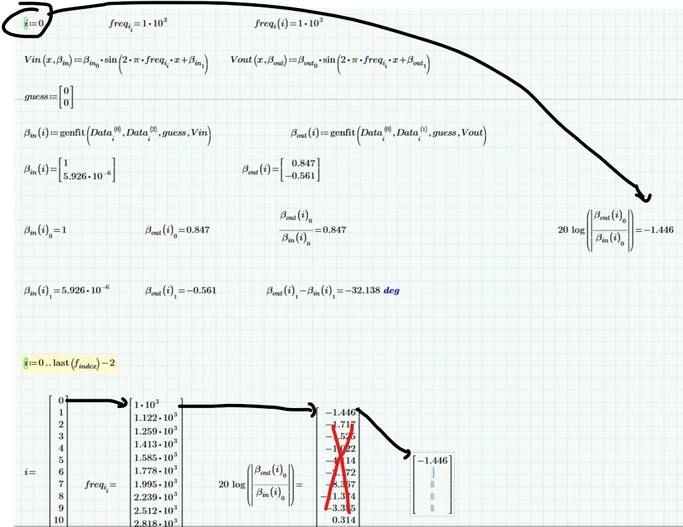

I want to extract for each iteration o i, the corresponding value in 20log() vector at index i, and put that value into another vector.

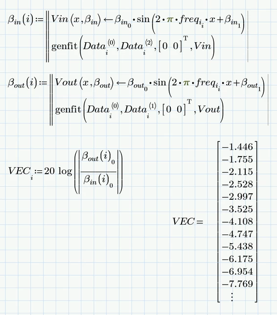

Apr 22, 2024 12:47 PM UTC
OMG!!
So the only problem was that the index i not only affects the data but also the function used for genfit!?
Then this should help
