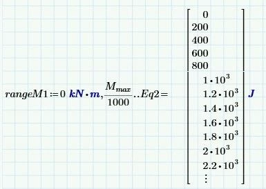

Error one is an easy fix. Use an undocumented trick.  If you inline equals after creating a range Prime will turn it into a vector.
For instance in the enclosed screenshot rangeM1 is changed to a column vector

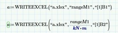

In the WRITEEXCEL statement simply divide by the units to get values without units exported to excel
The above writes into file a.xlsx the now column vector "rangeM1" into sheet 1 column B starting at row 1
