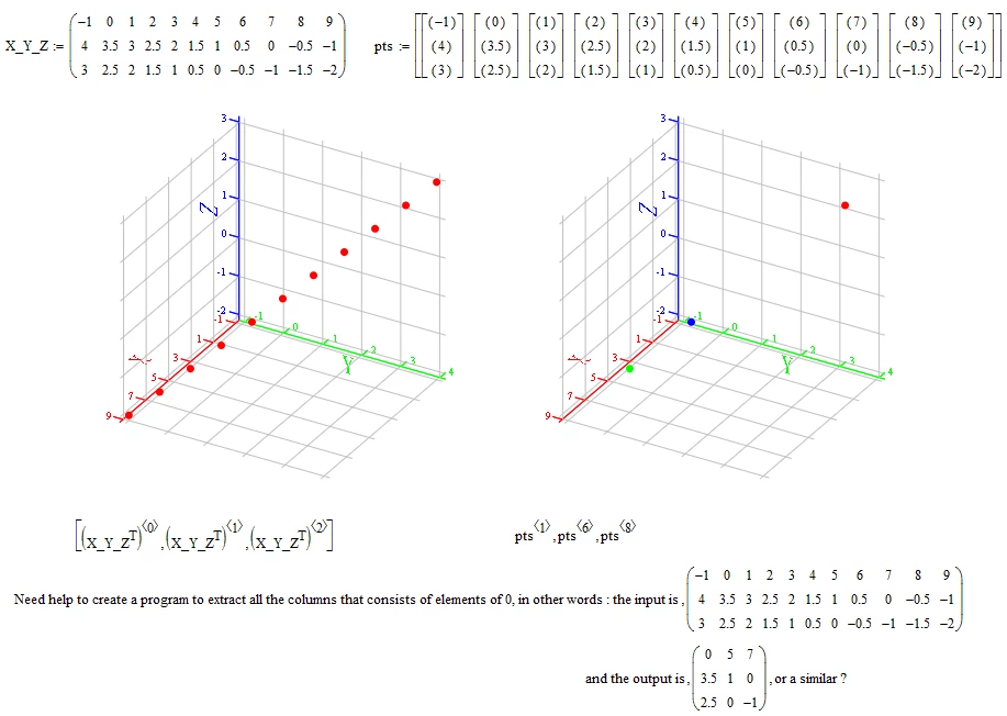

   Hello Everyone,
From :
  How to extract many columns that consists of elements of 0 ?
  Many thanks for your time and help in advance.
    Best Regards.
        Loi Le.

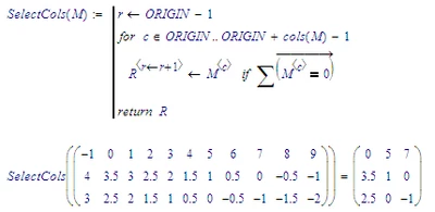

LucMeekesAnswer
October 14, 2020
Something like this?
LucMeekes23-Emerald IVAnswer
October 14, 2020
lvl10720-TurquoiseAuthor
20-Turquoise
October 14, 2020
  Many thanks again, Luc. I greatly appreciate your time and help.
      Regards.

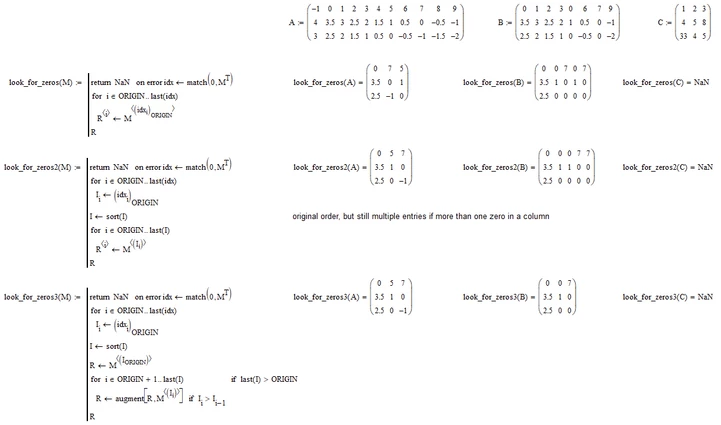

October 14, 2020
The attached file should help
EDIT: Alas, Luc has beaten me in speed and elegance!
20-Turquoise
October 14, 2020
   Many thanks for your time and help again, Werner.
      Regards.
