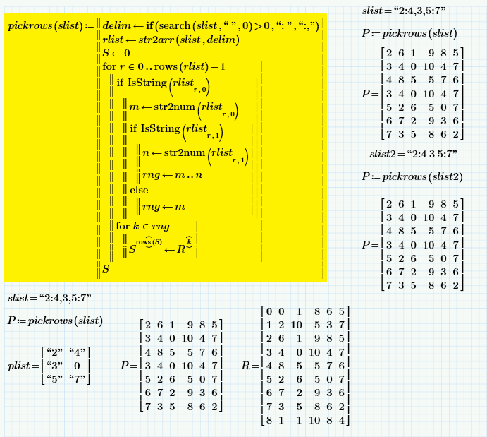

Here's an example of a function pickrows that will interpret a string as a range and pick out the desired rows. R is the matrix of interest. slist is a range that uses "," to separate ranges (as per normal Mathcad usage) and slist2 uses spaces to separate the ranges; both use the colon as per Matlab normal usage).

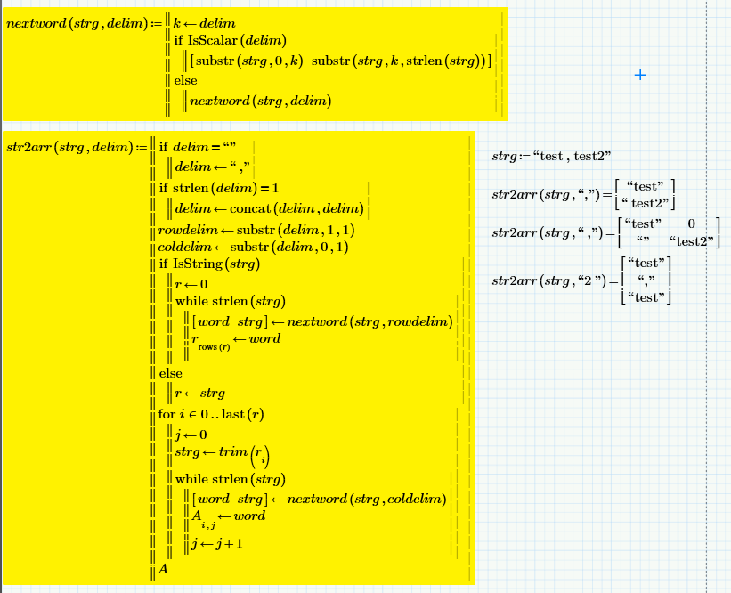

It makes use of my function str2arr that converts a string into an array, using a delimiter string "cr" where c is the column delimiter character and r is the row delimiter character.

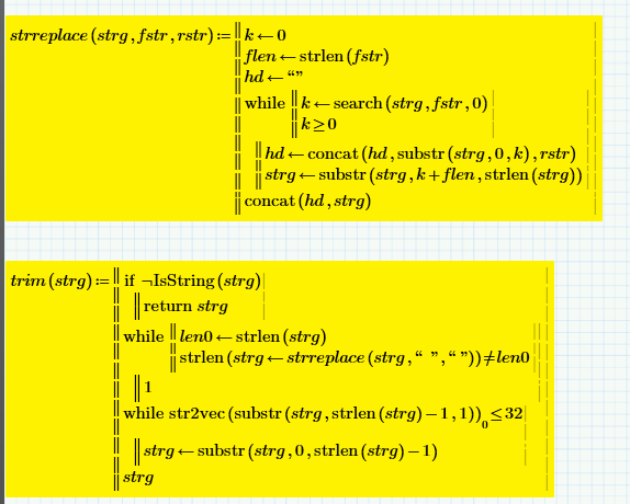

Functions needed to support pickrows ...

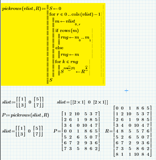

Entering the list of rows as a string seemed to be the easiest way to express the list, but a nested array is also a possibility - I've used a row vector format for the simple function below. The new function doesn't require any extra support functions, but, whilst the new matrix entry scheme makes it easier than M15 to enter an array, it's still nowhere near as simple as typing a string. Of course, what's really needed is an extended range notation that would allow the user to directly create the range (1..3),0,(5..7) as used in the example below or (10..20),(40..50),(70..80) as in the OP's original post.
