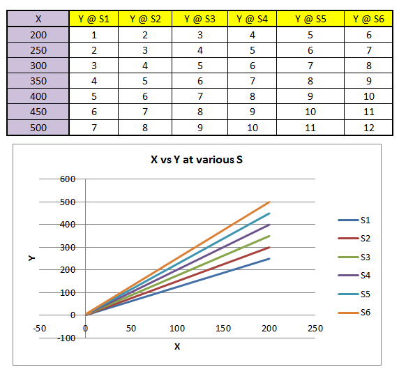

Dear All,
How to Obtain tha value of X for a particular S value between S1 and S2. Y is assumed to be known.
i.e, what will be the X-Y plot for a S value between S1 & S2.

You will have to interpolate between them.

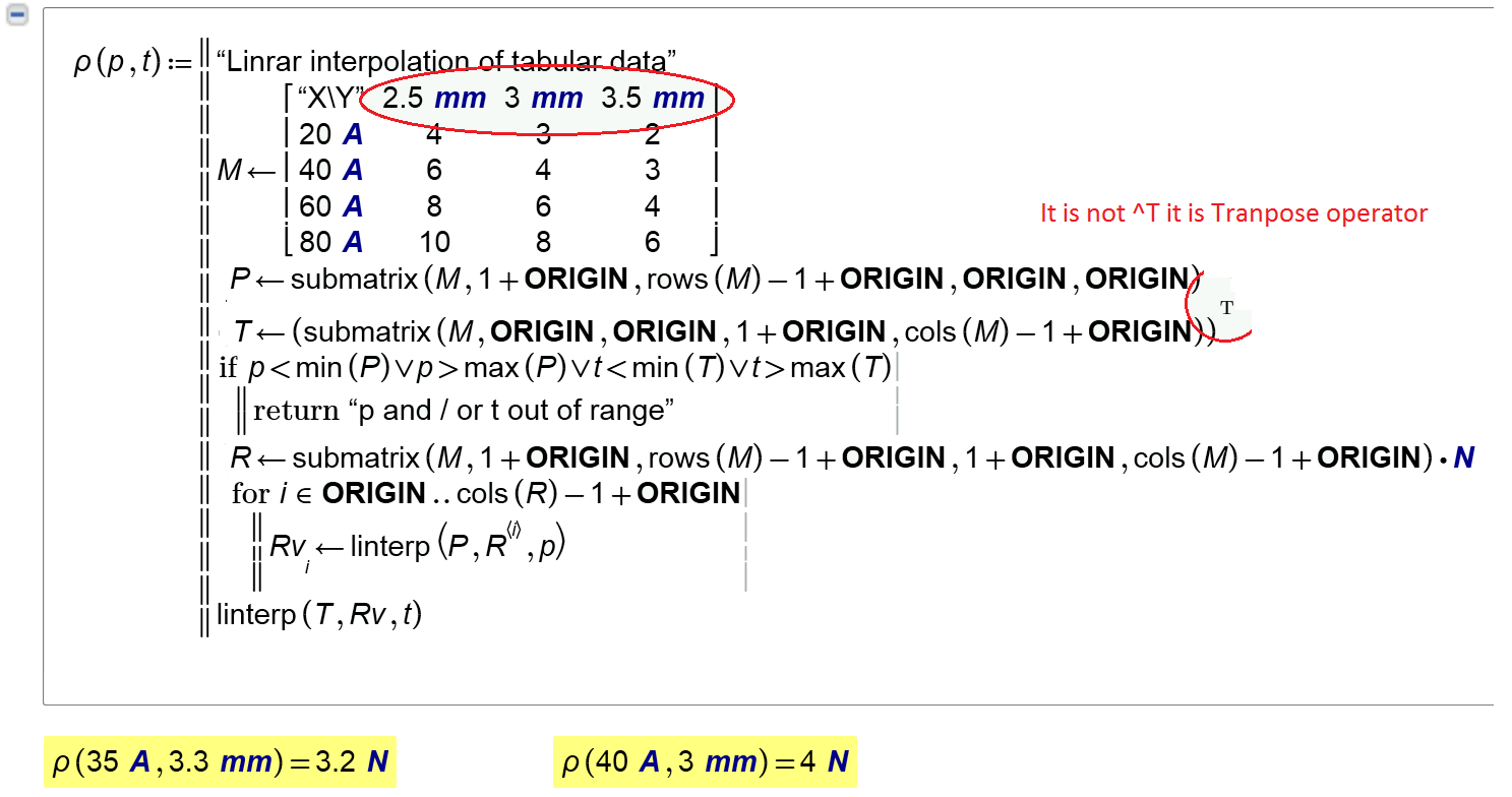

One solution
http://twt.mpei.ac.ru/ochkov/TTMI/1/1-2.png
Sep 30, 2014 5:18 AM UTC
Valery Ochkov wrote:
One solution
A plot of this function
http://twt.mpei.ac.ru/ochkov/TTMI/1/1-3.png
and if one value in the table is not correct
http://twt.mpei.ac.ru/ochkov/TTMI/1/1-4.png

The Y values on your graph are not the same as the Y values in your table. If the Y values in the table are plotted against X the only difference between the plots is the intercept of the lines. In your graph it looks like the only difference is the slope of the lines (although small differences in the intercept may just not be visible).

Looks like simple 2D interpolation.
You'll have to privide a worksheet.

Thank You all for the response... The solution provided by Valery Ochkov is what exactly i want. Let me try with that and provide the worksheet soon.
Sep 30, 2014 4:53 AM UTC
saranya tl wrote:
Thank You all for the response... The solution provided by Valery Ochkovis what exactly i want. Let me try with that and provide the worksheet soon.
I am glad to help you:
http://twt.mpei.ac.ru/ochkov/TTMI/1/1-1.xmcdz Mathcad 15
http://twt.mpei.ac.ru/ochkov/TTMI/1/1-2.mcdx Prime 3
All from
http://twt.mpei.ac.ru/ochkov/TTMI/1/1e.pdf
(The Chapter 1 from my new book "Thermal Engineering Studies with Excel, Mathcad and Internet" - http://twt.mpei.ac.ru/ochkov/TTMI/Preamble.pdf)

Those Document were really useful. I am getting an error of Unit Compatability.
Kindly find the worksheet attached herewith.
