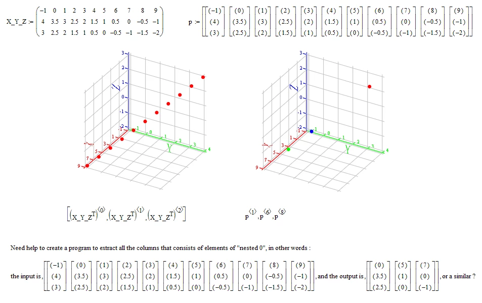

How to extract selected nested columns ?
  Hello Everyone,
  From :
  Many thanks for your time and help in advance.

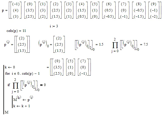

Werner_EAnswer

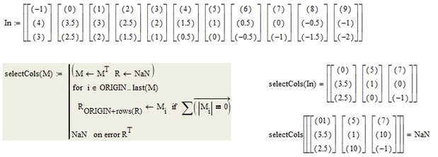

Inspired by (aka stolen from) Lucs solution in your other thread with a similar question

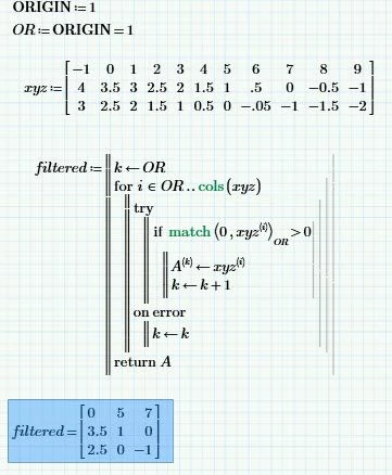

Werner_E25-Diamond IAnswer
