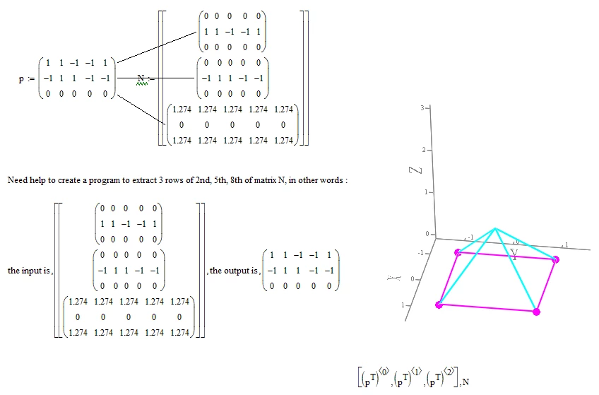

  Hello everyone.
  From :
  Many thanks for your time and help in advance.
      Best Regards.
           Loi.

If you just need it for plotting - why not that way?

Here's my attempt:

Many, many thanks to Luc and Werner. That's all of thing that I wish it, Werner. 😀😀😀
