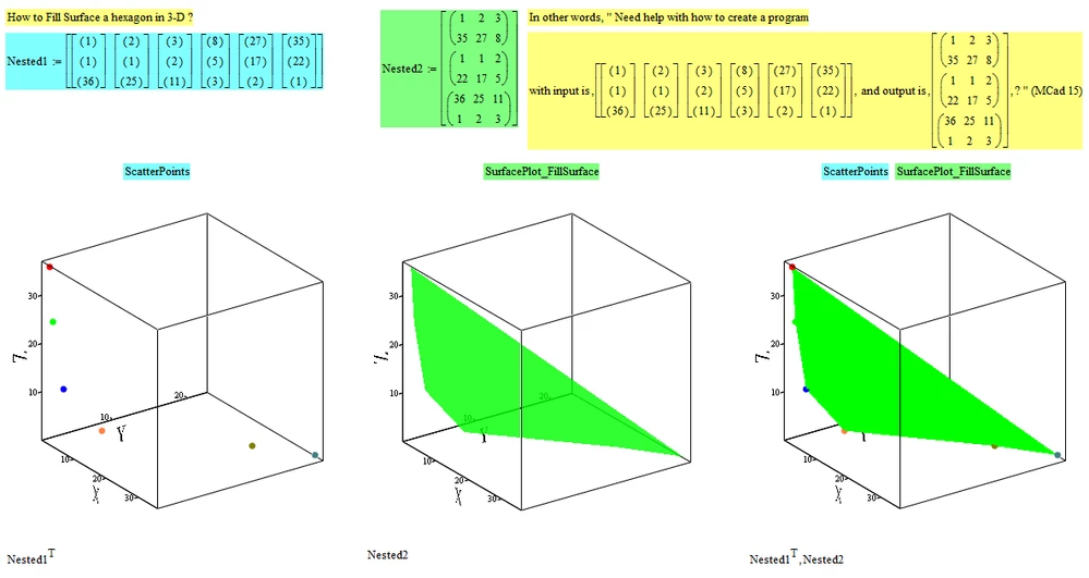

To close this thread (for me), here is a function to implement #4 in my list above. #1 - #3 will be up to you ore somebody else 😉
11 replies
The attached should do the job. Works for exactly six points only and the order the points are given is important. So its very specialized and thats the reason I did not made any attempts to make the program ORIGIN independent.

And if we get the input with random order of the points, and how to sort them for the program function always is true. And my belief is going to have a program function apply for any polygon, any order of the points and sorting say: Pentagon, Seven-Edge . . .
If you change the order, you get a different polygon!

Yeah ! you're right. A pentagon must be convex, and sorting that five points in accordance with certain rule, and Fill Surface !
