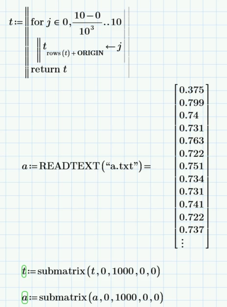

I have this signal formed by a vector data points:

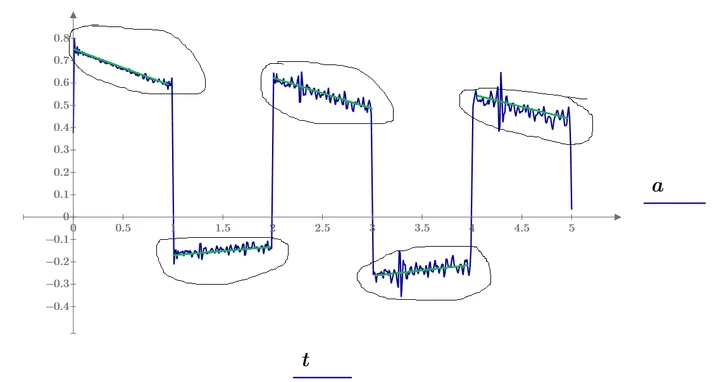

And I want to make the  blue signal (a) to look like more green signal interposed on the blue signal:
Is it possible to do something like that from the a vector data points?
Idea is that I want to have straight lines also on this portions of waveform:

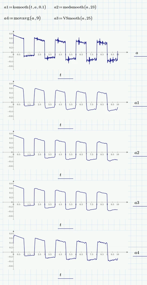

Jun 10, 2024 9:06 AM UTC
You may try the built-in data smoothing functions , play around with their parameters and see if the results fits your needs.
Werner_E25-Diamond IAnswer

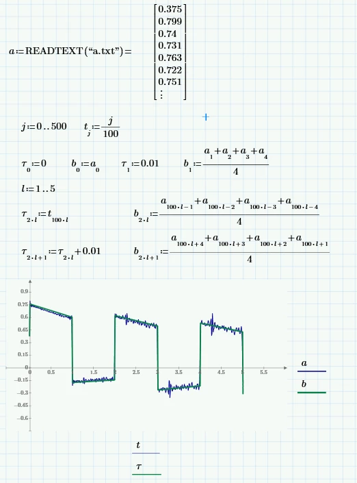

Jun 10, 2024 9:54 AM UTC
Here's another possibility (where the averaging is somewhat arbitrary!):
Alan

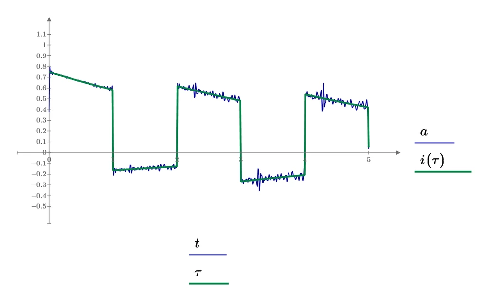

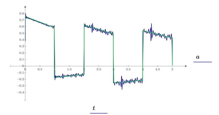

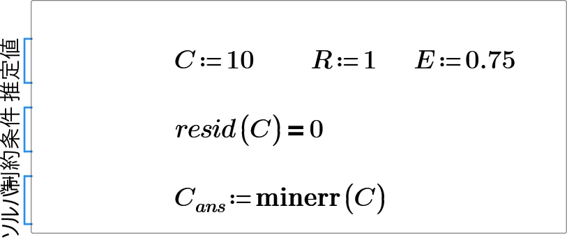

Jun 10, 2024 10:32 AM UTC
C=4 is fixed by hand. Using minerr for solveblock is more smart way to solve C.
t.t.
