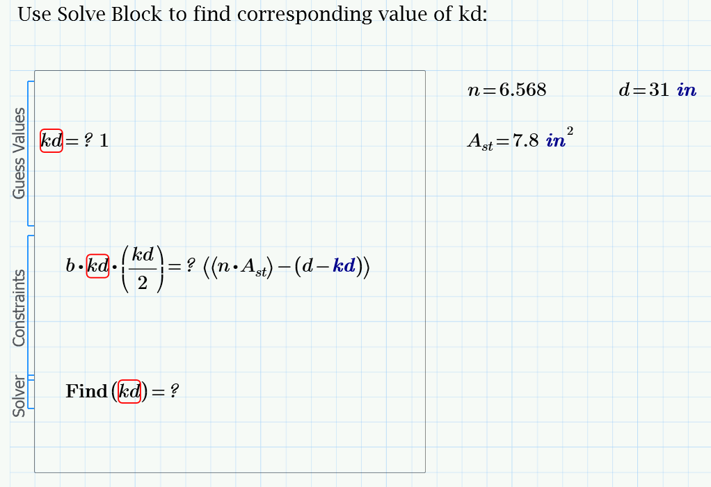

I come across these type of equations all the times where I have to find a variable displayed on both sides of an equation and if derived can lead to a quadratic or cubic.
However I would like to know if there is any way without deriving the equation, to find the value for me? I try to do this but it does not work. see image below.

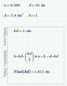

In the "guess value" section you need to define kd with the "definition" equals sign (:).
In the "constraints" section, you need to define your constraint with the Boolean "equal to" sign (ctrl+=)
Your equation is not unit consistent.  On the right side, you are trying to subtract a distance from an area (in^2 - in).  Perhaps the last bit is supposed to be d*kd?
You screenshot didn't show your value for b, so I assumed 1:

Thank you for your reply. the equation is suppose to derive into a quadratic and then solve the variable. I wanted to know if there is a possibility to solve it without having to derive it or if Mathcad can derive it into a simplest form, how?
