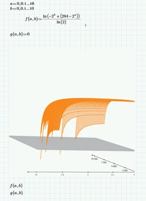

How can I solve this equation f(a,b) = 0 ? Orange plot - f(a,b), grey plot is zero surface, so as you can see orange plot intersects grey plot 4 times, so there should be 4 solutions. Root() works fine, but by this method I have to change manually  guess/initial values. Is it possible to get all solutions together for ex. in a matrix ?

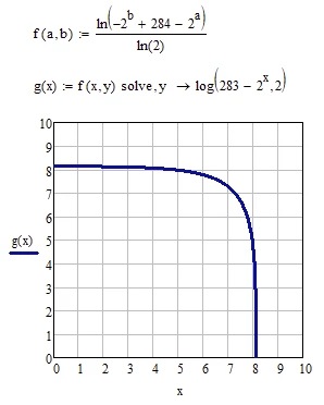

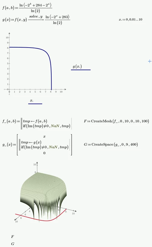

In your case its quite easy. For each value of x there is a solution. That way the matrix with all solutions you are asking for would be too large for Prime - after all there is an infinite number of solutions ... 😉
You simply can symbolically solve f(x,y) for y and you get a function g(x) which consists of all solutions:

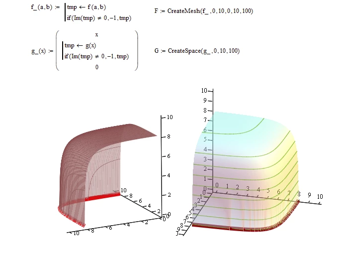

Can also be done in Prime, but of course with a much more limited 3Dplot (no transparency, no contour lines, no lighting and much more artefacts at the border where the surface is extremely steep, and ... you name it, Prime is missing it 😉 )

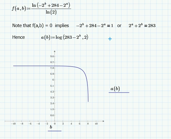

As Werner has noted there are an infinite number of solutions.  Perhaps the easiest way to see that is as follows:
