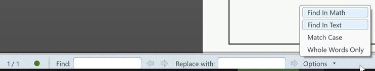

This feels like a silly question, but I have not been able to figure out how to find and replace text in Prime 9 from the help or other posts.

Look at the bottom of the Prime Window
But don't expect too much comfort and functionality - especially when it comes to subscripts, etc.
Here is the chapter in the help
To Find and Replace Alphanumeric Characters
but I agree that Prime's help is not very well structured and things are often hard to find.

Oh my goodness, the status bar is on the BOTTOM? I feel silly but also that is not where I would institutively have guessed.

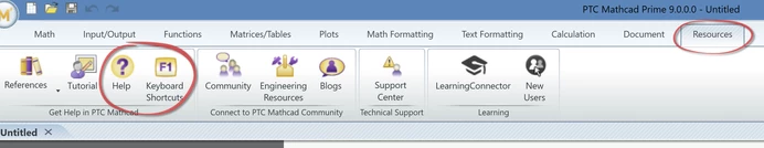

Is there a hotkey associated with the help?
Mar 31, 2025 6:13 PM UTC
F1, as with most other software ...
You may also access it via the menu at the "Resources" ribbon and lookup other keyboard shortcuts
In case "Resources" does not show up you can enable it in the options.
When Prime is installed you have the choice between using the help locally installed or the online version which I referred to.
