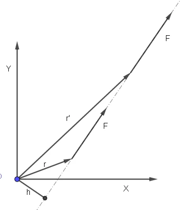

August 28, 2018
Thank you all, this picture illustrate your answers in 2D
Sorry for this stupid question

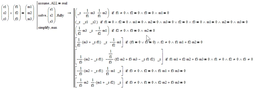

August 28, 2018
There is no single, unique solution.
Normally you will have one degree of freedom and the solution may depend on one parameter.
The expression below may be simplified if we could assume that the scalar product of M and F is zero.
Unfortunately Mathcad won't let me add that assumption.
