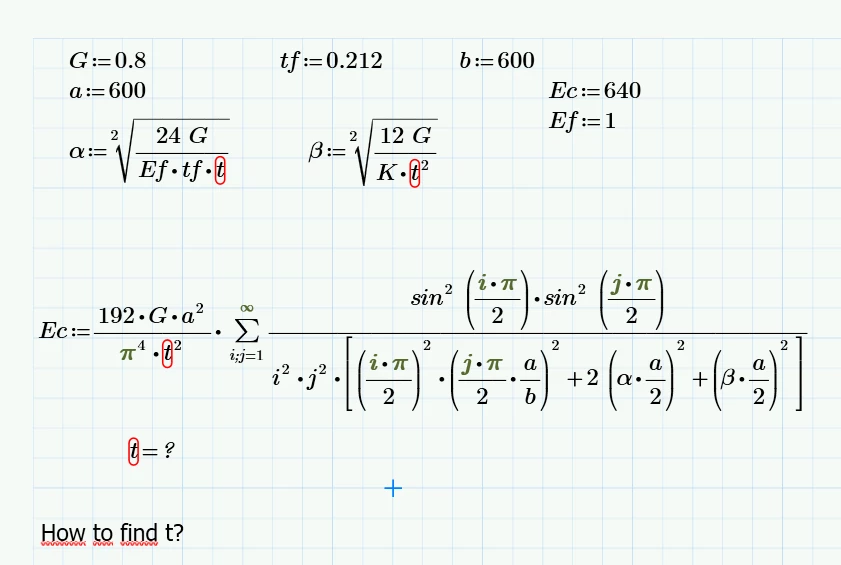

Attach please the Mathcad sheet!
July 6, 2021
ok sorry, done..
July 6, 2021
July 6, 2021
What is the value of K?
This is needed for the solution.
Cheers
Terry

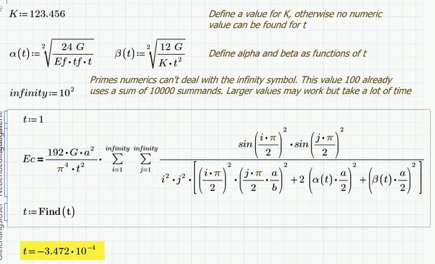

July 6, 2021
Not sure if the following is near to what you are looking for:
P6 worksheet attached
