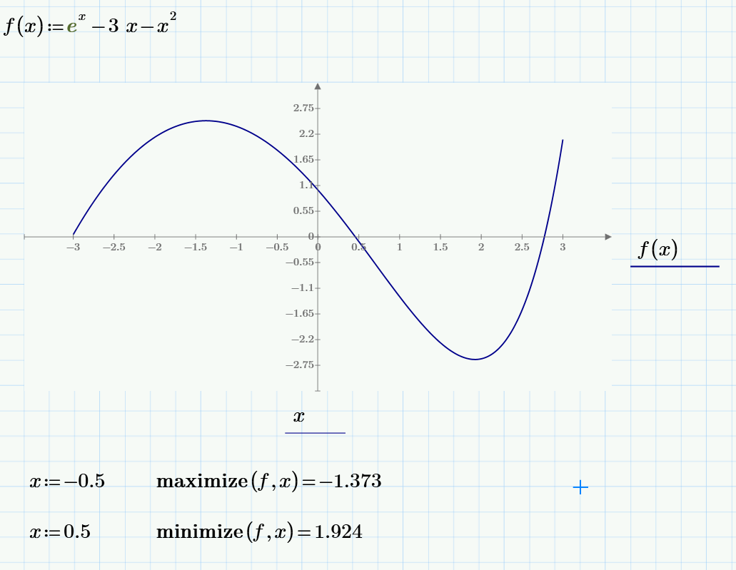

Suppose f(x) is the following function, defined when x>0.
f(x)=e^x - 3x - x^2
Use Mathcad to find the x-coordinate, to 2 decimal places, of the critical point f(x).
Question: How to input this function into Mathcad to get the x values? Any takers to help, I am new to Mathcad.
Best answer by ValeryOchkov

Sometimes we don't need uncle Wolfram:

Thxs all for the help... I am still in the learning phase... Sorry for the trouble
