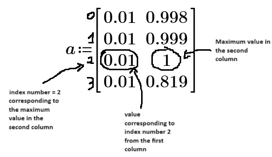

Lets say that I have this matrix:
I want to find the index at which the maximum value in the second column is obtained, and the corresponding value at that index in the first column.
Like below:

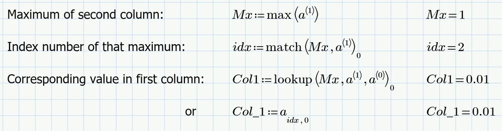

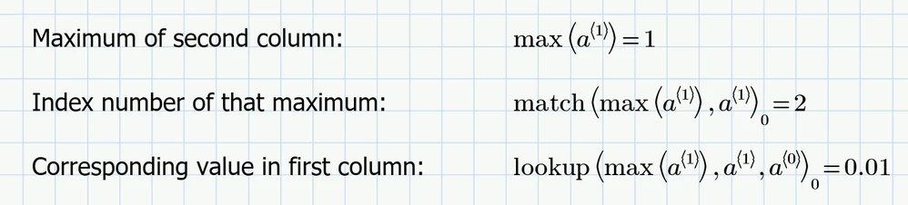

You may want to familiarize yourself with the "match" and "lookup" commands in the help section.
or alternative with the use of variables
