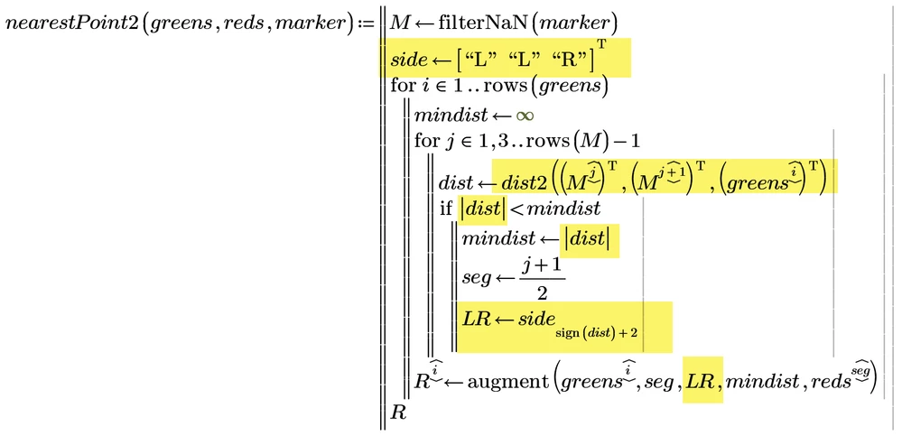

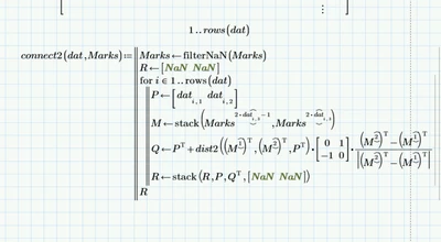

Concerning your new question I don't think that i can help. The function "connect2" you reference is a function which creates the data structure necessary to plot the line segments from every green point to the red LINE nearest to it - that way visually showing hat minimal distance.
The function is called "connect2" because it followed "connect", which would do similar but by connecting each green point and the nearest red point.

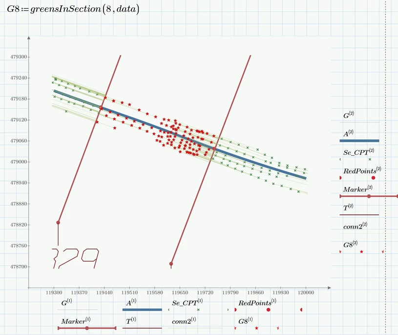

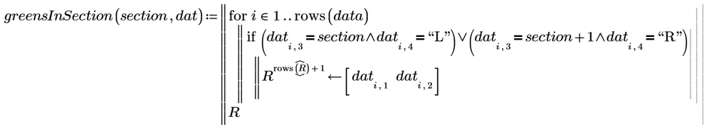

In case you just want to create a list of all green points within a certain section, we could add the information, if the point is left or right of the red marker line
and use this information to select all points within a section
Example:
In the attached P10 file I got rid of all regions not relevant to the question. If you can reduce the sheet further, please do so before you re-up it again. Smaller sheets make life a lot easier!
Example:

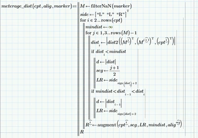

Hi Werner,
Actually I tried to write this program depending on your previous solution>> to find the distance between markers and the previous green points
when I say before I mean example : distance between  marker 2 all greens(cpt) (which located in between marker 1 and marker 2 )
dist3 will be ( marker3 and all greens located in marker 2 and 3)
Do you think what I wrote is correct? >>> I'm asking because I honestly don't know why I used (seg) I just follow your steps

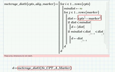

also tried this one:
