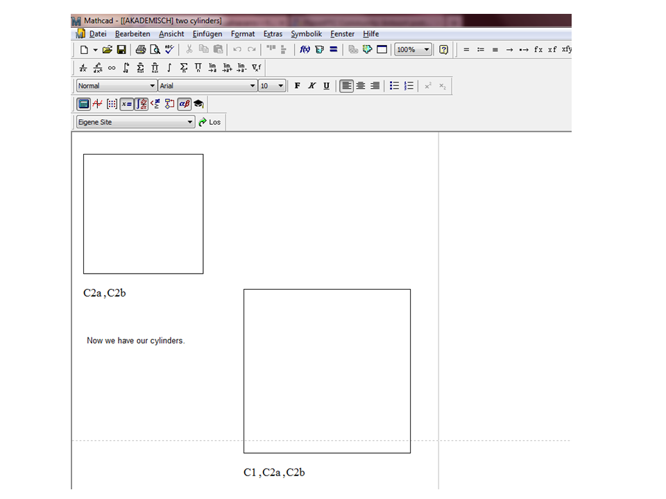

Hallo,
I would like to ask for your experience. I need to find the volume with triple integrals between 2 cylinders. They are not along the same axis.
To imagine how they are found, they form a cross, like this: +
The first one is an ordinary cylinder and it follows the form z= 3 sin (phi). This was really easy.
The second one is an elliptic cylinder. Here are starting the problems. The area of this second cylinder is given by x^2/a^2+y^2/b^2. For a = 2.6 and b= 3.0
But I just can transform this second one into cylindric coordinates and at the same time turn it 90° from the first cylinder to form this "+" cross.
Do you have any idea?
Thanks a lot!
Best regards.

July 30, 2011
Here is a basic MAthCAD document... it is missing the main part =S
23-Emerald I
July 31, 2011
Is this what you mean about two cylinders?
If so, then we can move forward to develop the integral
July 31, 2011
Hi Fred
You´ve got it! Wow, yes it is like that. How would you start the integral?
Due to a some reason, I can not see the graphs...
Thanks y lot!
