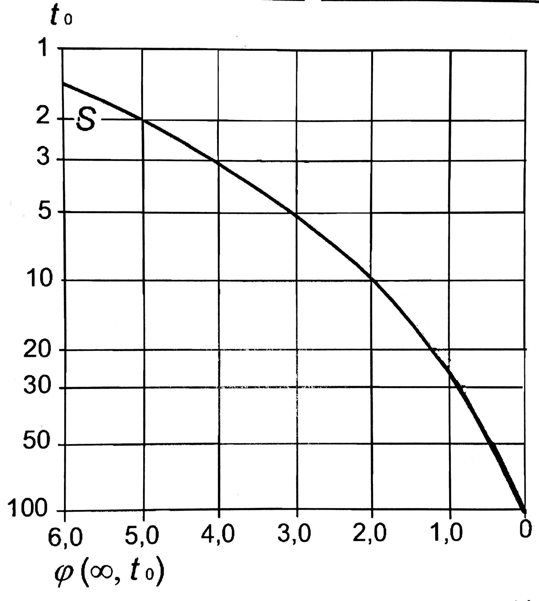

How to fit a curve when i have only a drawing and the corresponding values?
As it can be seen in the attached picture, I need to find an equation to fit this curve if I have only the data from the picture. Since this is a graphical method, I can't have a high accuracy but I need a generalized function that would give me the value for every point. As you can see, the values in Y-axis are not linear so I have no idea about the type of the function.

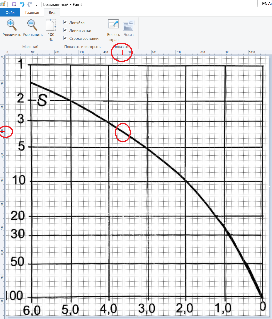

November 16, 2016
Create at first vectors X and Y using for example Paint

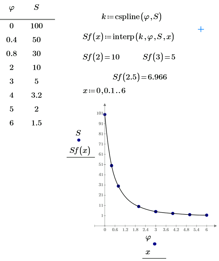

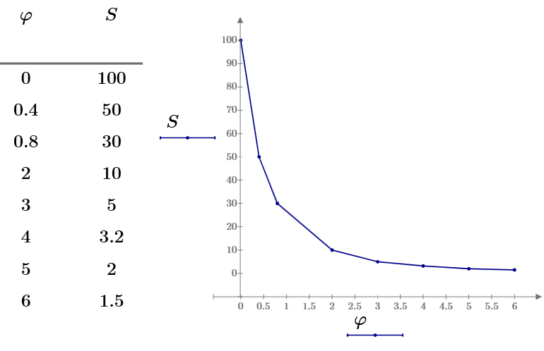

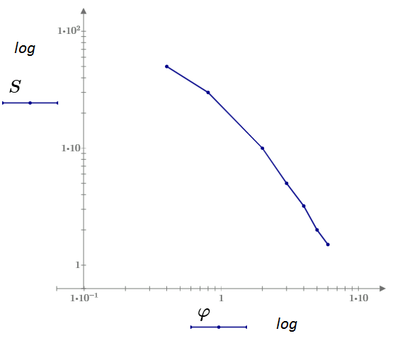

November 16, 2016
Or as first step (sorry - I have no time to show last steps - later!)
