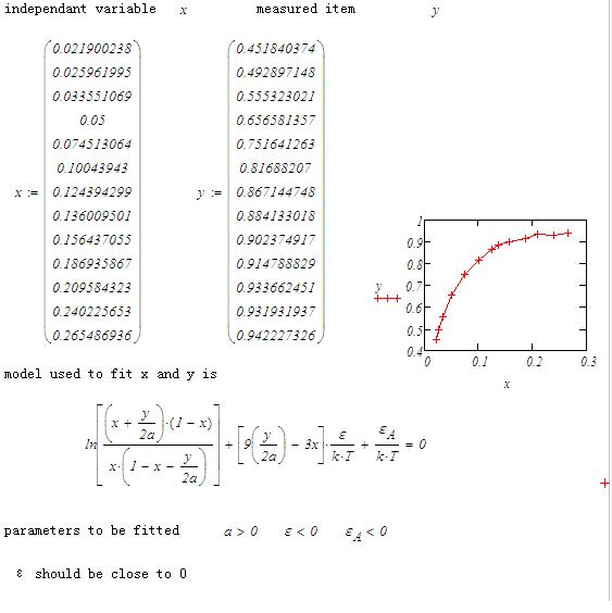

The question is described as following. An model function with implict form is chosen to fit the experimental data (x,y)
unknown parameters to be fitted are a, epsilon and epsilon_A.
I dont know how to evaluate parameters with the implicit form model in mathad.
does anyone give me some suggestions?

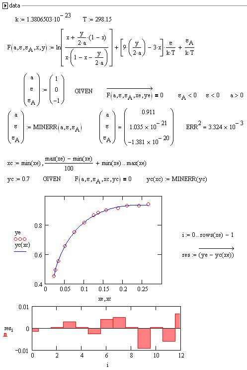

Best answer by ViktorKorobov
Look at my solution. I assume k= Boltsmann constant (?); T= Temperature, K (?).
For MINERR use option Levenberg-Marquardt.
6 replies
November 30, 2010

thank you so much, viktor
and I will try to change the initial value of epsilon to a "0-close" negative value (according to its physical significance) to see whether this code can work (I forgot the T in my thread, it should be 384.15, but you have guessed the value of k and T)
I think I always have problems in using MinErr of Mathcad ( very unfamiliar with this function).
thank you again for ur great help
