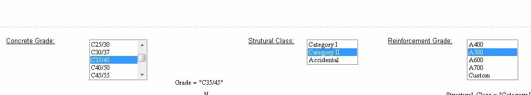

I am using the solve block Find function to find the two unknown from two given equation
If my guess value is not close enough to the correct value it give a error message "The variable is undefined"
Please refer the PDF attached.
I have a curious question why to define the range of the unknown just above the Find function if function can not use them to find the correct values.
May be I am thinking wrong !
I have attached the Math CAD file when opened please input the same as referred to the attached "INPUT DATA" so to have the similar results.
Is there a way to instruct the Math CAD Find function to do the increment between the given range instead of guess value as I am finding it difficult
Because for every problem I have to enter the close enough guess value to get the right results.

Right click on "find", and check "AutoSelect" (which is the default, so at some point you disabled this).

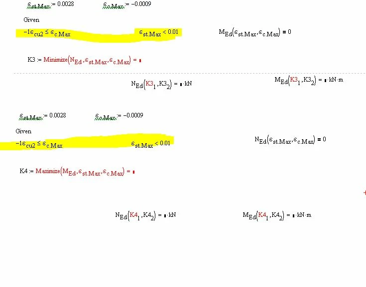

Now I have the issue with Maximize & Function I don't know why, May be I have syntax wrong
Please see the attached

I just Modified the Guess Value Range for Maximum and minimum function (for the "4_EN 1992_Stress Vs Strain Rec Parabolic_Max Min.xmcd")
See the attached
