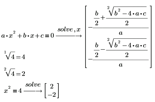

Mathcad has no standard provisions for this. You could try this:
success!
September 22, 2016
Hi Luc.
¿1i greather than zero? That's must to be a bug.

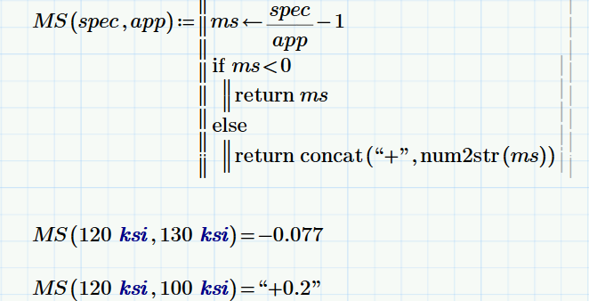

I don't believe you can force the plus sign as a number.  You can build a character string:

Fred,
Thanks. I am new to Mathcad. Can you share your file?

mzanial1-VisitorAuthor
September 22, 2016
Thanks all. I really appreciate it. Another problem is I am new to Mathcad. Even if the apparent solutions shown, I am having difficulties making them work. Bear with me 😃
