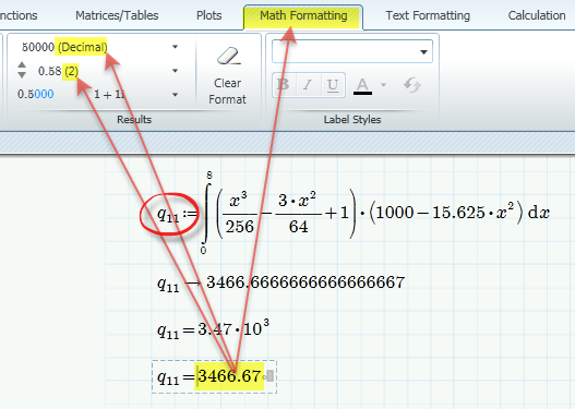

q.11 is the result of a definite integral and is NOT dependent on x. So it does not make much sense to define it as a function of x. Its a simple numeric variable and you can display it the way you want using normal numeric evaluation with the appropriate formatting options. No need for symbolic evaluation.
