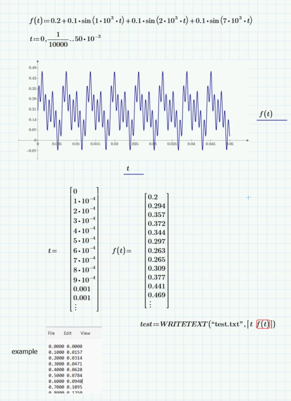

CCornel19-Tanzanite1 year agoJul 2, 2025 7:23 AM UTCSolvedHow to generate a txt file with two column of data points2 replies431 viewsTranslate AllHello,I want to generate a txt file with two columns corresponding to the t and f(t) variables. MP10 file attached. 1_generate-txt-file-with-points-mp10.zipMathcad Usage
