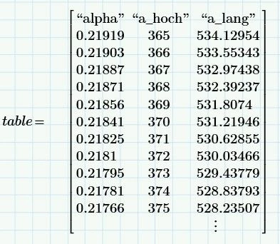

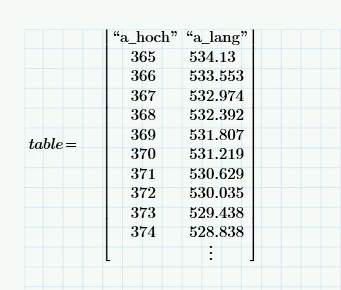

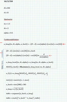

I have this function with a table which shows the "a_hoch" and "a_lang" values. I want to show the angle "alpha" as well in this table. How could I do this? Unfortunately I can not upload the file.

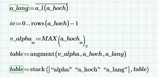

You did not say but assumed Prime 11

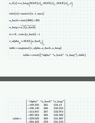

Sorry I use Prime 7. Tried to implement your formula but get strange alpha values.
Sorry but I can not upload my file.
Could you help me again?
