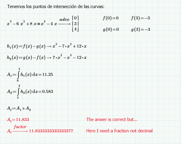

Mathcad Prime gives me 11.833 as answers but need to get and show the equivalent fraction 71/6.
How can we convert from decimal to fraction?

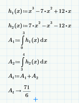

Get rid of the numeric evaluations

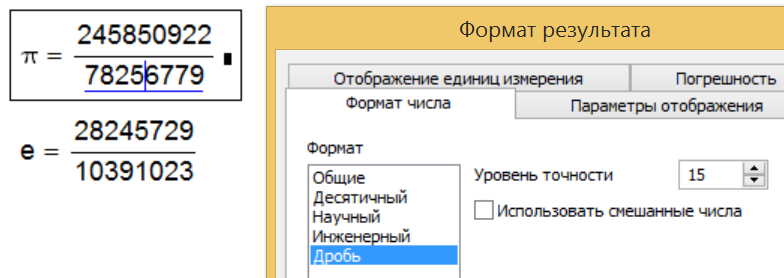

In version 15 you could format your result as a fraction.  If you do that and convert to Prime (3.0) the result is a decimal.  Prime (again, 3.0) does not have "fraction" as a choice in Math Format.

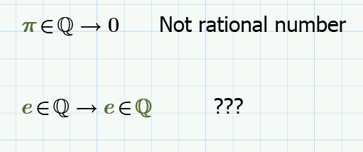

New rational number

As Fred already stated is the inability to format a result as fraction one of the many missing features of Prime (compared to Mathcad).
Maybe you could use symbolic evaluation?
