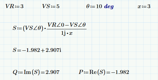

I have the following information and I'm trying to get matched to solve it for me symbolically so i don't need to do it by hand
Can anyone help with this error I'm getting?
I basically want it to give me the real and imaginary parts and assign the symbolic representation to variable P and Q
How do i do this?

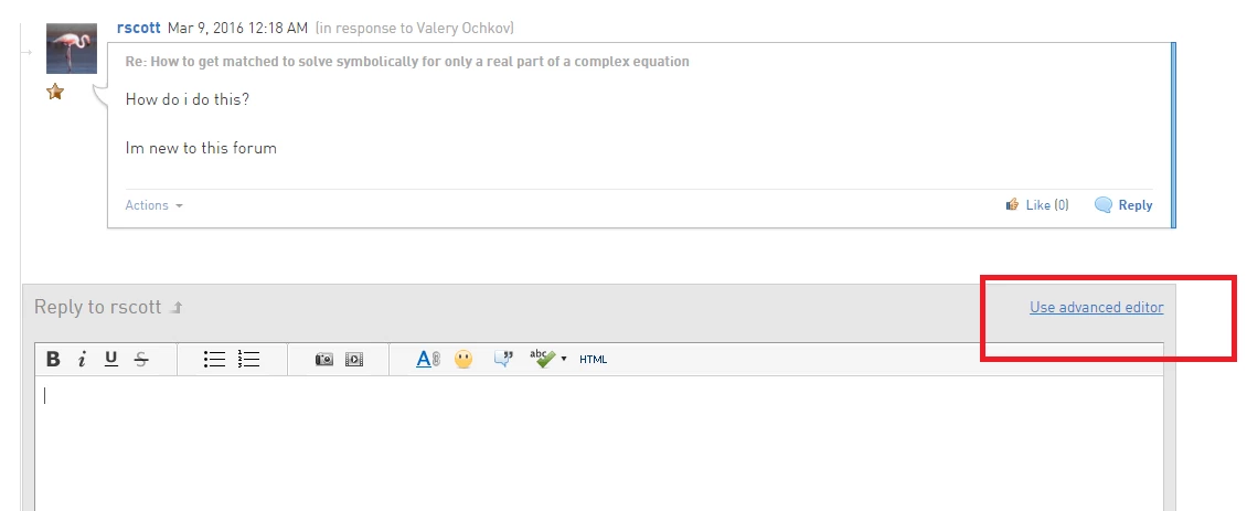

How do i do this?
Im new to this forum
March 9, 2016

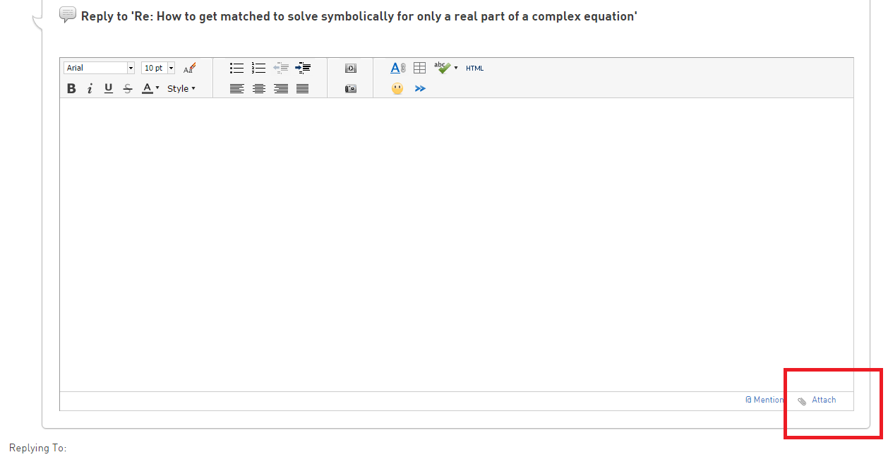

When you reply you need to click on "Use advanced editor" in the right upper corner and then "Attach" in the bottom corner:

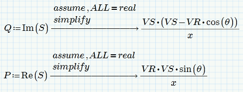

No i want it symbolically because i don't know what those values VR theta etc are
So i need an analytical equation for the real and imaginary parts.

I would like math cad to give me an expression for the real and imaginary parts as a function of those terms
VR, VS, Theta , x

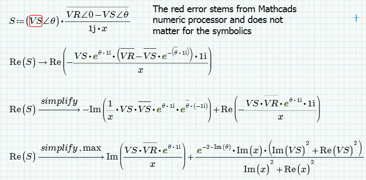

By default Mathcad's symbolic assumes that all variables could be complex numbers, so the result is not really helpful
You have to tell Mathcad, that theta, VR, etc. are real values, maybe even that VR and VS are positive (or zero). If we assume that x is a real value, too, we can do it in a very simple way:
If x could be non-real, too, things get a bit more clumsy
Hope this helps
